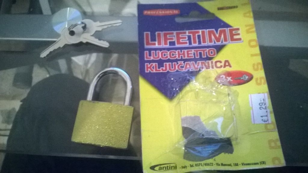

So i have been picking a lot of locks since i first got my lockpicking set which is an C2010 slimline since i live in Europe. Here is a little guide i decided to write so that i could share my experiences and tips.
1 tip; Get an lock. In Eu i would recommend you to get this Image from an 1 Eur shop as they seam to be single pin. (which is great to practice on ).
