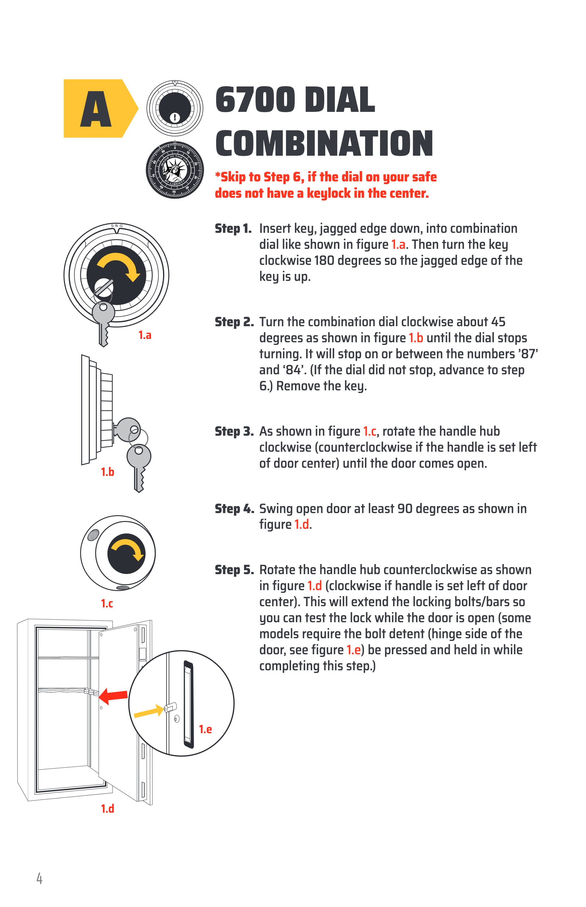

Thank you. Searching through the Liberty Safe Quick Start Guide confirms my hunch:
https://d2zvhg7xe2wt47.cloudfront.net/m ... 4965_4.jpg
To be specific, this should be the equivalent of the Sargent and Greenleaf 6730-112.
