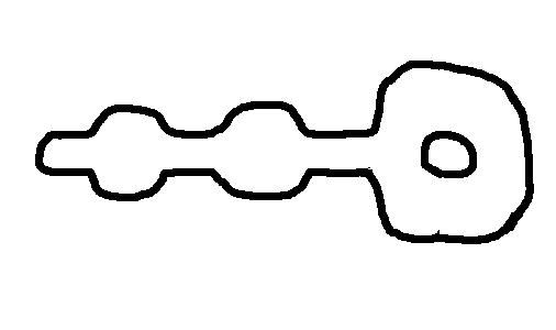

I'm assuming you're talking about those really little padlocks that go through to metal holes secured to each side of the diary. Is it a pin tmbler padlock or a warded lever lock? The former has a key that looks like a normal key but is really small. The latter has a key that looks like....
The former (pin tumbler) can be picked using a 2.5mm headed tension wrench and simply jiggling while turning. The latter (warded lever) can be picked with, as Varjeal said a stiff piece of wire bent into a "L" shape.
