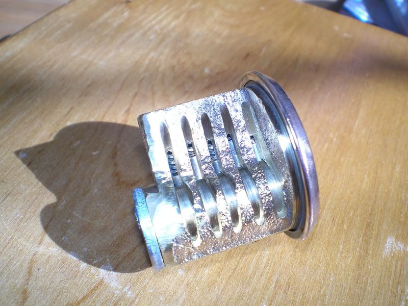

After receiving a shipment of Zekes locks (see: buy and sell forum) i decided to turn one into a cutaway to help some friends that are getting interested in lockpicking.
the lock is below:
Now i can actually see the pins i have a question from something that arose....
when i can see that the pins are all at the sheer line (as in where they should be in order to open the lock) the lock still doesn't open. In order to open it i lightly rake it with a rake or just the tip of the hook. Now i can't work out why this is happening?
Surely if all the pins are at the sheer point they should open the lock? sometimes i have to give other locks a quick scrub to open them after SPP them but i always assumed this was because a pin was not quite set. I am sure that they are all at the sheer point in this case but it still needs to be scrubbed? Perhaps this is what is happening to the others that i have to open like this?
any info would be great!

I've noticed this happens to me sometimes due to the tension wrench dragging on the sleeve or 1~2 pins are a hair off the sheer line (usually raking will fix that). Other than that you might want to try lubricating it and see if you get some better results.

Also, what's up with the second chamber from the face? It looks like the spring is too short to contact the top pin. If I was ever suspicious of an over-set pin it would be in a chamber without any spring pressure.

Second chamber has spring pressure... its ust an illusion similar to that of the last chamber.......
Perhaps i will put some new pins in it and see how that goes.....

that's an interesting effect, it looks like there's nothing between a small portion of the spring and the top pin. For extra sloppiness/debugging you could also replace the top pins with short, blunt bottom pins. this will effectively turn any cylinder into a Kwikset but it's great for doing quick demos.
As for new pins that's a great idea. My Russwin that I got from zeke had some minor damage to the bottom pins (bumping/snap gun/epg I guess) and had a few burs on them. Not to say that this was unsuspected from used locks, just made picking it a little harder :-).

Ah, i see the effect you are talking about now... you can actually see the top and bottom pins in the second stack..... It does look like there is a HUGE gap although that is actually the top pin.

Jow wrote:Ah, i see the effect you are talking about now... you can actually see the top and bottom pins in the second stack..... It does look like there is a HUGE gap although that is actually the top pin.
Disregard that post... im going to have to look at the original to work out whats actually going on there.....
