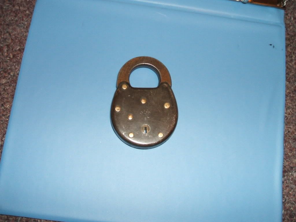

i have an old lever lock with four levers in it. has anyone picked one of these things open yet.

Gonna need more details than that dude. mainly as its antique. If it is the chances are its best to get it done professionally. But if your determined lets have a look at some pictures.

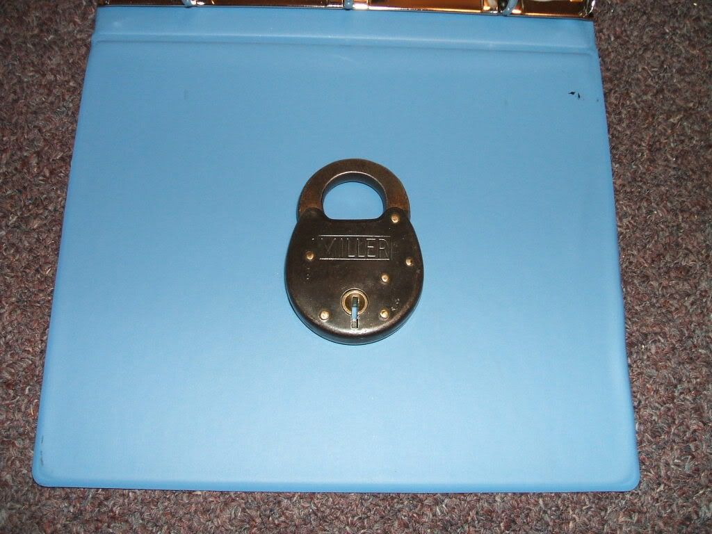

http://i151.photobucket.com/albums/s132 ... ure031.jpg http://i151.photobucket.com/albums/s132 ... ure032.jpg
heres some pictures of my lock and moderator you can delete the previous post my error on downloading info.

Postby Shrub » 11 Mar 2007 7:33
What you have thewre is a differant type of lever lock than we would normally talk about in the uk as a lever lock,
Yours uses a flat key, these will still have square cuts on and turn into the levers to lift them to height and open the lock,
You are gogin to struggle opening this lock with no previous experiance as they are so tight inside,
As some advice you need to look at this a bitdifferantly now and use differant tools as wires arent the best,
You need to consider how to tensionm the lock, this may be doe with a cut down key blank or small wire but remember you need to get on the moving part and tension that, tensioning the keyway will do nothing and should infact just spin around anyway,
Tension the lock and then use a hook pick to lift the levers up, this is gogin to take prtactice and if the locks reasonable will be quite a challenge for you,
If you look at the Falle basic picking set you will see the european kits get some 'lever lock picks' well these are the same sort of thing,. you use them to lift thelevers instead of the normal turning a tool into the levers to lift them,

Postby greyman » 11 Mar 2007 15:56
I thought you meant Miller 6-lever push-key padlock. If anyone can pick these beasties, I'd like to know about it. You cannot directly tension the bolt!
For the 4-lever Miller in your photos, you need to make some manual lever picks - make them quite strong, out of some welding rod or something stiff. Not sure about the size of tensioner you're going to need - experiment with this. I'd mount the lock too, or else you'll need 3 hands :)

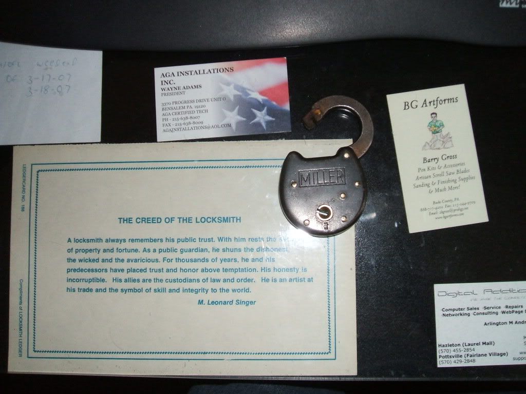

http://i151.photobucket.com/albums/s132 ... icture.jpg its open and i dont like picking lever locks but it shows me just how much i need to learn so i will buy more locks and practice some more.i quess a 2in1 tool would be a wise buy does the new master padlock work off the same theory as the miller maybe i will try and pick that one.thanks for all the help.

Postby JackNco » 11 Mar 2007 16:56
OK im only going from the picture of that lock but that looks like a curtained lock, the master is not a curtained lock. so no a different tool is used.
Some one correct me if im wrong?
