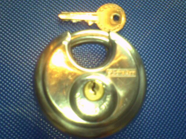

Hello guys, this is my first post ( and its in the wrong place) Anyway i guess you guys are going to laugh, but i have this cheap lock, its a Securit disk lock, i have tryed evrything with it, and i cant even set one pin :? ive tried varying my tension, and nothing..Any ideas?

Postby Shfake » 27 Jul 2007 9:14
Ok thats it http://i183.photobucket.com/albums/x253 ... _A0924.jpg
Sorry about the blurryness of the picture

Postby cjames73 » 27 Jul 2007 9:14
its just a normal type of discus lock similar to the abus.
i have picked 2 of these locks and they are quite easy to open. if you cant yet SPP it you should be able to rake it open.

Postby Shfake » 27 Jul 2007 9:17
I can SPP and rake locks, ive tried both, and nothing, cant even set a pin

Postby Eyes_Only » 27 Jul 2007 9:29
Could this lock contain security drivers? I've never messed with these types of padlocks so I wouldn't really know the difficulty level of it
Postby cjames73 » 27 Jul 2007 9:32
from what i remember there is no security pins in these locks. the keyway is quite small though so may just be oversetting pins.

Postby Eyes_Only » 27 Jul 2007 9:38
Perhaps a slimline pick will do better than most picks to prevent the shaft of the tool from oversetting the first two pin stacks while working the back of the lock.
Postby Shfake » 27 Jul 2007 9:38
The keyway is small, and another thing ive noticed, in all my other locks there is a little amount of play in the cylinder, but in this lock there is nothing, ive tried evrything i can think of with it, but i cant get it open, oh well thanks for the help guys :)

Postby nekret » 27 Jul 2007 12:31
You might also want to crank up the tension a bit, some of these locks have very stiff return springs that make it hard to tension it properly.
