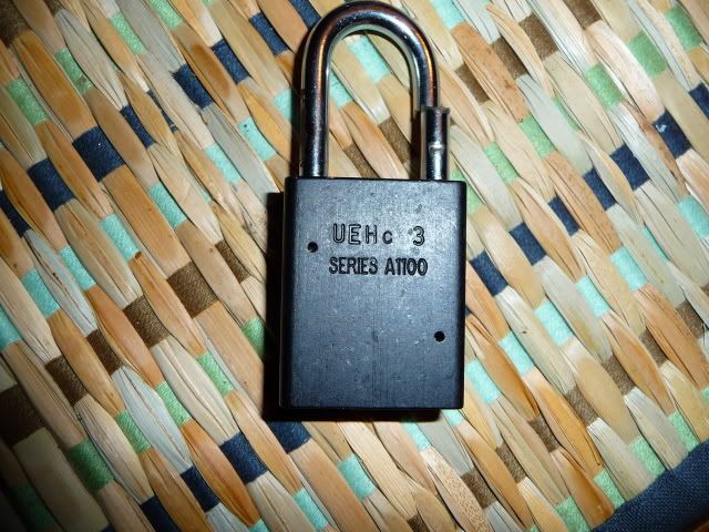

Postby Pancho » 15 Oct 2009 17:59
I've recently started this hobby and I got my first pick set 2 days ago. I can now open a Kwikset deadbolt with no problem so I tough I would try something more interesting. I found one of these padlock in one of the "junkboxes" my father has in his backyard. After reading this thread I think I'm a little over my head and have one question my lock has in the back the letters "WFH" instead of the "UEN" any idea what that means? or where can I found some more info on it?
Thanks
Pancho

Postby Squelchtone » 15 Oct 2009 19:00
Pancho wrote: have one question my lock has in the back the letters "WFH" instead of the "UEN" any idea what that means? or where can I found some more info on it?
Date Code of manufacture.
I have an explanation of how to decode this to a month and year for your code listed in THIS thread.
Your lock was made in April '97, mine was June '01

Postby poor paperclip picker » 15 Oct 2009 20:54
squelchtone wrote:Date Code of manufacture.
Do you know what the "A" means on the bottom of the lock, on what you called " pop can tab looking thing"? Also on my american A1100 series, next to the manufacture code, there is a small "c" then a "3".
Don't mind the cut shackle, my friend lost the keys and used this to lock their shed. They had it cut, and knew I liked locks so he gave it to me. :D
