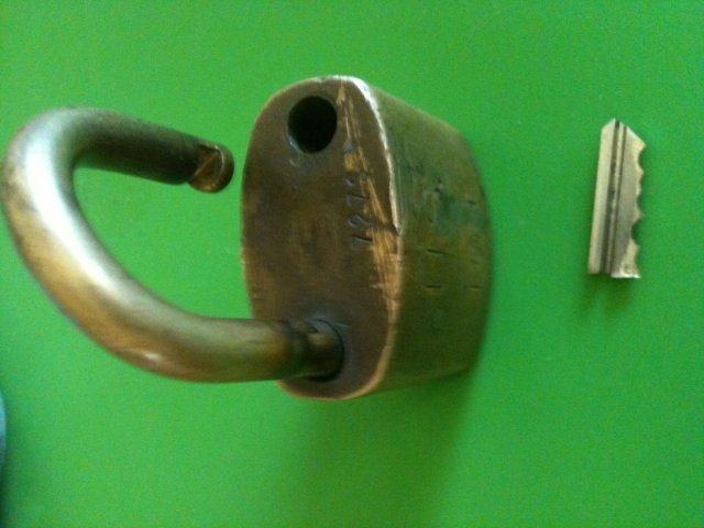

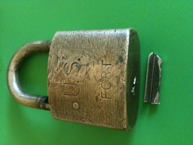

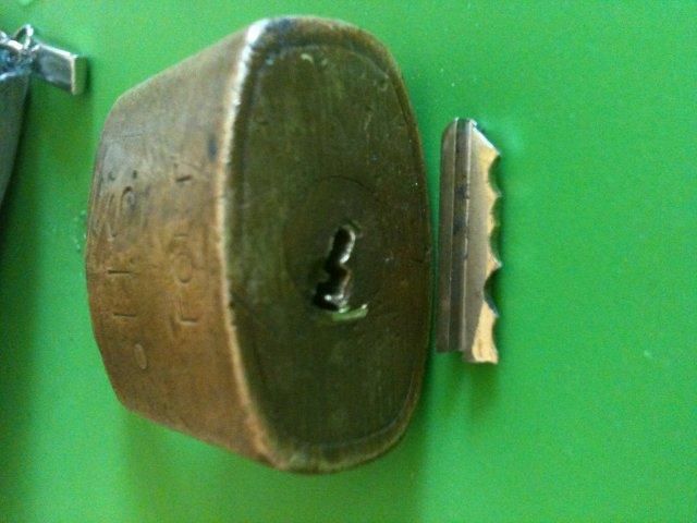

New acquisition today - a brass padlock, cheaper because it had a key broken off inside it. Markings are:
U.S. FORT on front, 727S on top. All brass, including the shackle. Don't know much about it, but I figured people here would. Don't let me down, folks!
The key was broken off just after the first pin, so the pin was helping to keep it in. Removed the key using an old E string from my guitar, with a tiny hook folded onto the end. When removed, it was obvious that someone thought the same way I do... the blade was knifed, the bitting was round. Someone was trying to impression the lock, used too much effort, and broke off the key. Oops!

BTW... This lock picks only with a FEATHER touch on the tension wrench AND on the pick.

Congrats, you've just saved a nice old padlock! Now it's your turn to find a few blanks and impression a key for it.
