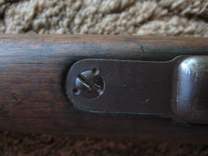

cledry wrote:Did you peen them so it doesn't happen again?
You just taught me something new. A quick google search gives me an idea of what this is, but I'm not quite sure. What does this involve,- simply hammering the screw while it is in the lock?

Postby cledry » 21 Mar 2012 6:44
sandplum wrote:*her* advice
:oops: My humblest of apologies, miss Sandplum
Example.
Re: Key is difficult to remove from medeco door lock
Postby gibson » 21 Mar 2012 11:30
Is that the rarely seen Enfield lock? Honestly though, I would use the kind of lock-ite that is meant to be used on screws that might have to be un-loosened, or a clear nail polish before staking the screws
Postby raimundo » 23 Sep 2012 8:58
enfield is it,
and that 'peening' is done with a center punch, which is struck so that the metasl mash together and resist turning, I usuall punch at the end of those screw slots spalling some metal into that groove but this only works where the screws are countersunk, as they typically are on the mortise cams.
a lock that has been worked on by a locksmith can loose some of this metal when the screws are removed so the locktite option is also good.
