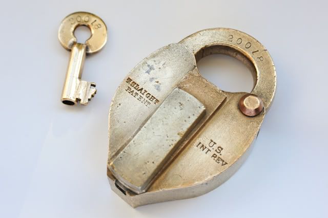

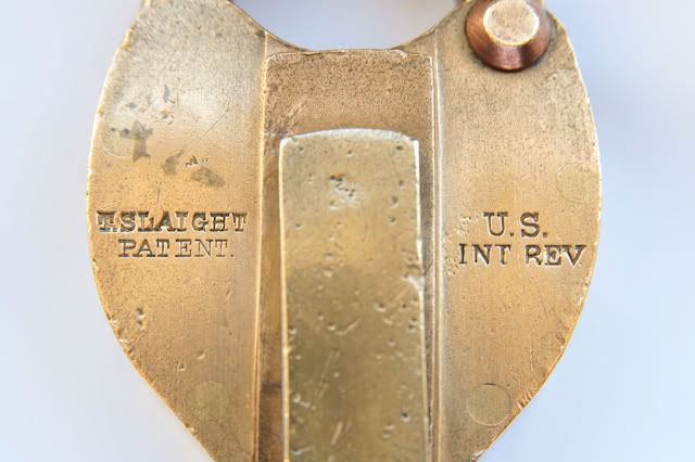

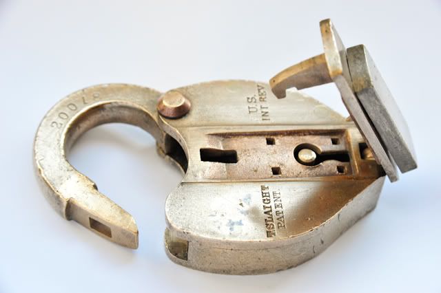

Thomas Slaight of Newark, New Jersey filed the patent on his new "paper seal" padlock on November 13, 1872 and received US Patent #141,519 on August 5, 1873. (There is a typo on the first page of the patent document, indicating "1878" for the issue date of the patent, which is incorrectly reported in a few different sources.)

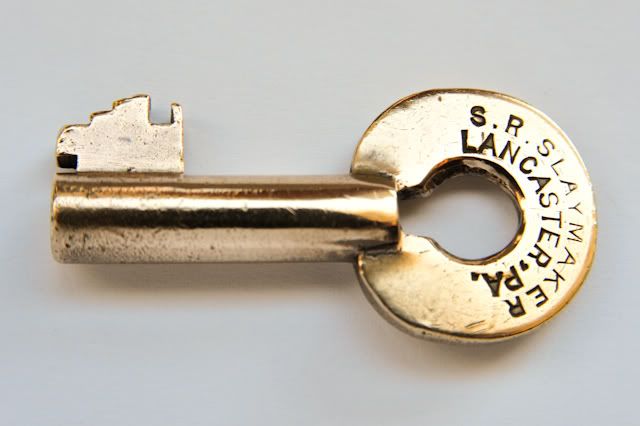

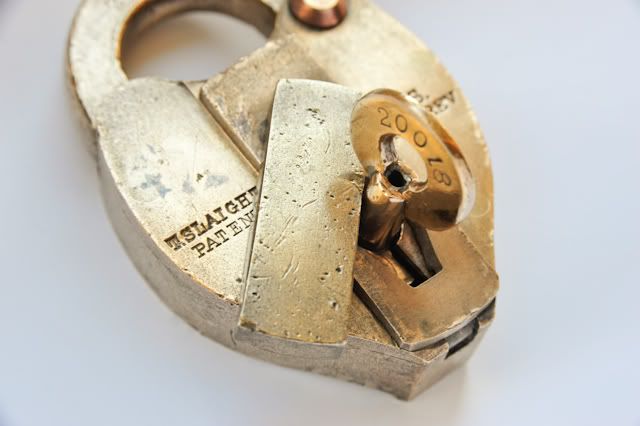

These heavy-duty padlocks were manufactured from cast brass. The key is a simple, single-bit key and the keyway is similarly uncomplicated: there is a single post, with minimal warding, and no curtain protecting access to the 3 locking levers. The key turns counter-clockwise to throw the spring bolt and open the lock, and the warding is simple, with two notches (one on the bottom of the key, and one just above the top-most lever cut) helping to hold even heavily-worn keys in proper alignment with the lever pack. The keyway itself is covered by a spring-loaded cover, designed to help keep the padlock somewhat clear of rain, snow, dust and dirt.

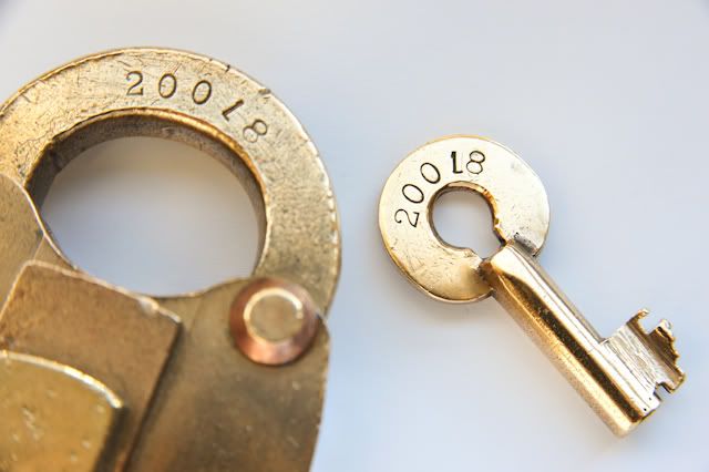

The keys and shackles are stamped with matching serial numbers.

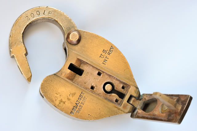

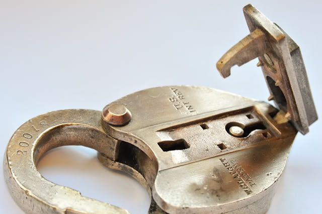

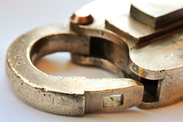

The locking design was well thought-out, with a dead-latching mechanism that prevented shimming of either the shackle or the seal cover:
      "Note that the tip of the shackle has a hole which the locking bolt enters, what we would now call 'deadbolting.'"
      • Source: National Locksmith, Guide to Antique Padlocks

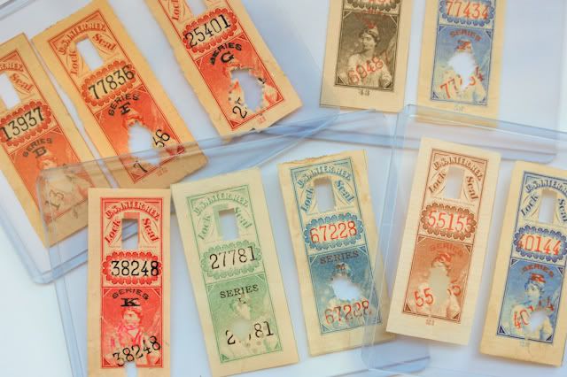

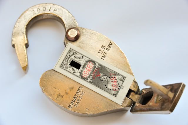

The "seal" on the lock was a piece of paper, inserted behind a special locking plate.
The plate securely held the paper in place, directly over the keyway; in order to open the lock (with either a key or with lockpicks) you first have to break the paper seal. Spikes in the plate hold the paper seal firmly in place, so it cannot be slid out of position.
For extra tamper-resistance, the seals have the serial number repeated over the area that the key (or picking tools) would have to punch through in order to gain access to the keyway. Starting in 1888 the colours of the seals were also regularly rotated (initially every 30 days).
      "The sheets of seals printed by the Bureau of Engraving and Printing are sent out from Washington to the Collectors of Internal Revenue and by them distributed to the different storekeeper gaugers in their respective districts. A record is kept by each collector of the number of sheets sent, serial letter, date, etc., and a report is made by the gauger, accounting for each seal received."
      • Source: United States Internal Revenue Stamps: Lock Seals (Walter W. Norton, 1912)
While the seals are sometimes referred to as "stamps", they were printed on non-adhesive paper, in sheets of fifty-four (six rows of nine seals per sheet). When cut, the individual seals are 18mm wide and 48mm high; from the selection of stamps I have (spanning from the early 1920's to the late 1940's), it appears that the sheets of seals were hand-cut as needed, rather than machine-cut.

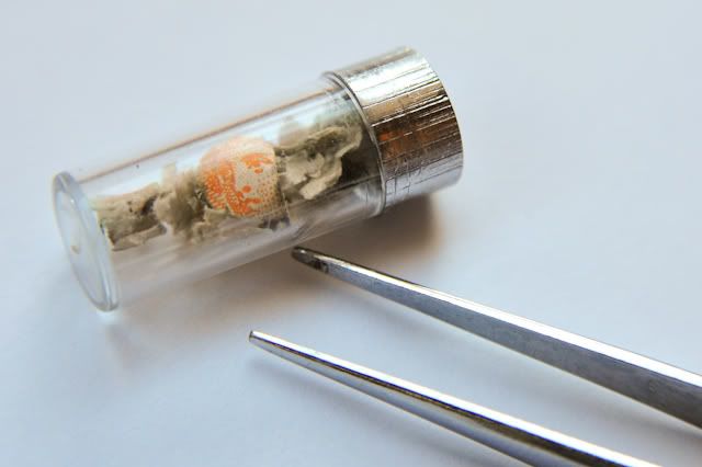

The inside of the lock and key stem naturally pick up bits of the seals as they're punched in by the key. The layering of seal paper "sediment" inside the lock can provide a rough means of dating when the lock entered and left service, and whether it was kept on and used privately (e.g., by a distillery) after their use was no longer mandated by the government. The following picture shows the collection of paper seal shards that was removed while cleaning a single seal padlock and key:
