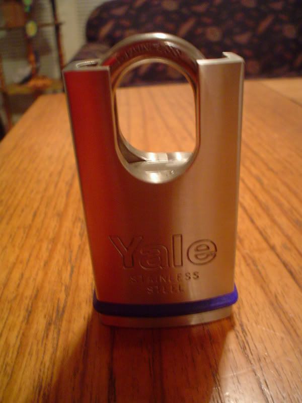

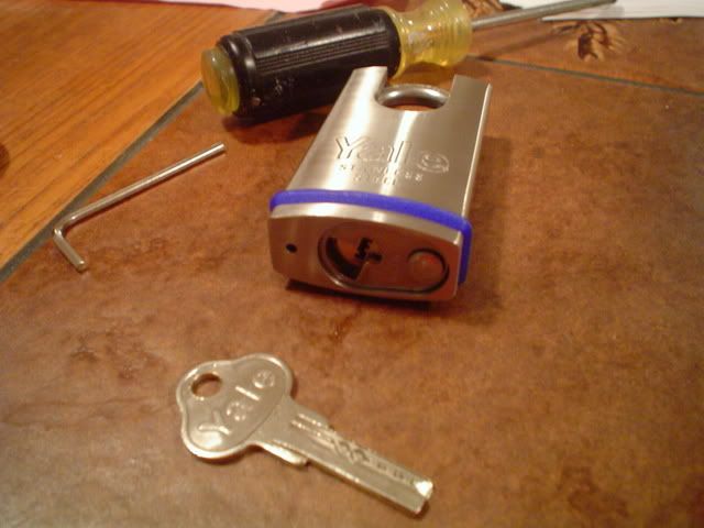

This one of my favorite locks I bought off Ebay. I didn't have a dimple lock yet so I decided to get one. It cost around $12 after shipping. Here's the inner workings:
Shrouded.

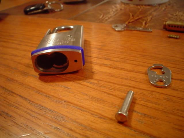

You can see it has an anti-drill plate.
Housing.

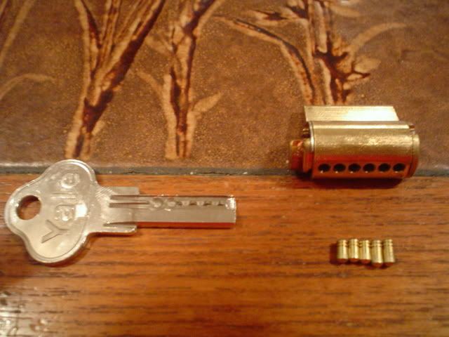

Double serrated pins.

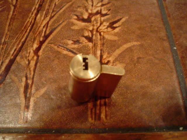

The lock core.

nice looking lock. nasty looking key pins. what are the driver pins like? if its still open could be cool to take a close up pic and stick it in the Pins thread.

seems to me like all they accomplished by putting the keyway sideways was giving you a key that could be put in either way and greatly limiting the key cut possibilities and the differences between cuts.

That cylinder looks exactly like an American Lock cylinder: drilled for 6, pinned with 5, and the same size and shape.

The lock appears to be made in taiwan (look at bottom plate) so not original Yale

JackNco: I wanted to see the driver pins too, but I was scared I wouldn't be able to put them back in.
linty: This might be true, as thet key pictured above only has two different depths, however, with the serrations and restricted keyway it is extremely difficult to manipulate.
n2oah: When I was playing with it the pins inadvertently fell out. And looking at the sixth hole I thought I had lost one when I could only find five. Only later did I realize that whole was superfluous.
maxxed: Globalization makes it so there is not doubt to the origin of that lock. You'll be hard-sought to find a lock made in the US or Europe save the expensive high-security locks. If any doubt remains, it came in its original packaging. That is a Yale lock.

I'm with n2oah on that one... if that's the case all you'd have to do (unless you have a proper plug follower) is use the plug turned sideways to hold them in... (Yeah I know "stating the obvious") :oops:
I've took my american apart like that many times. To me that's not much of a dimple lock because the pins don't have much to move before setting and there's only 6. But, I suppose it would throw someone off that doesn't know about that lock.
