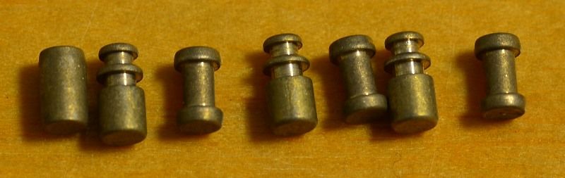

Postby zeepia » 27 Mar 2013 17:16
Biltema oval cylinder, solid pin is the last one.

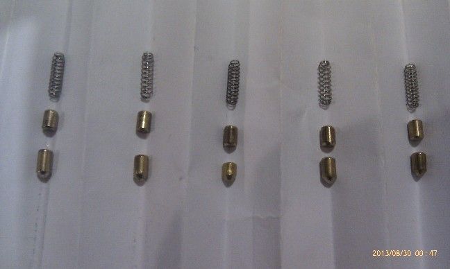

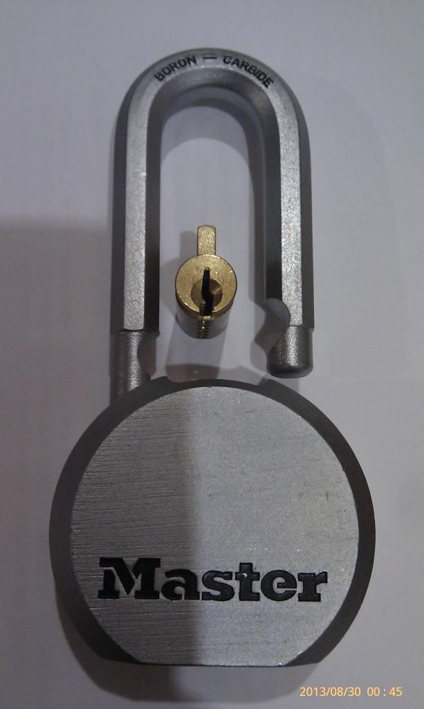

Postby Extremepeta » 29 Aug 2013 22:42
Guts of a Master M930 Magnum Series padlock:
All standard/normal driver and key pins.
It also comes with a small piece of rubber on the bottom for weather protection but I removed it for ease of picking a while ago and can't find it.

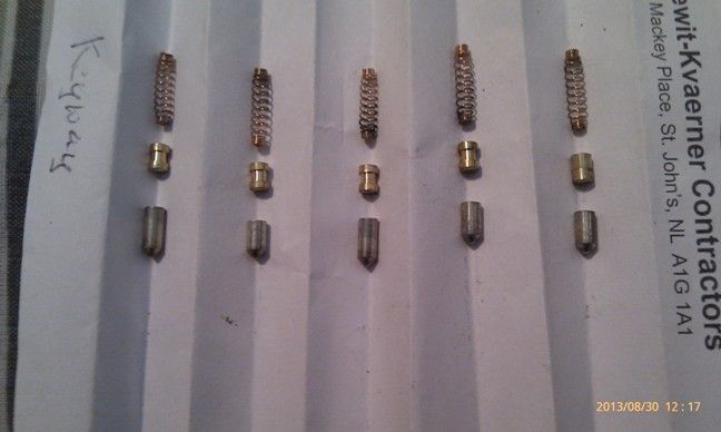

Postby Extremepeta » 30 Aug 2013 10:04
Schlage single cylinder deadbolt.
4 spool driver pins in positions 1-4; 1 normal/standard driver pin in position 5; 5 standard/normal key pins.
