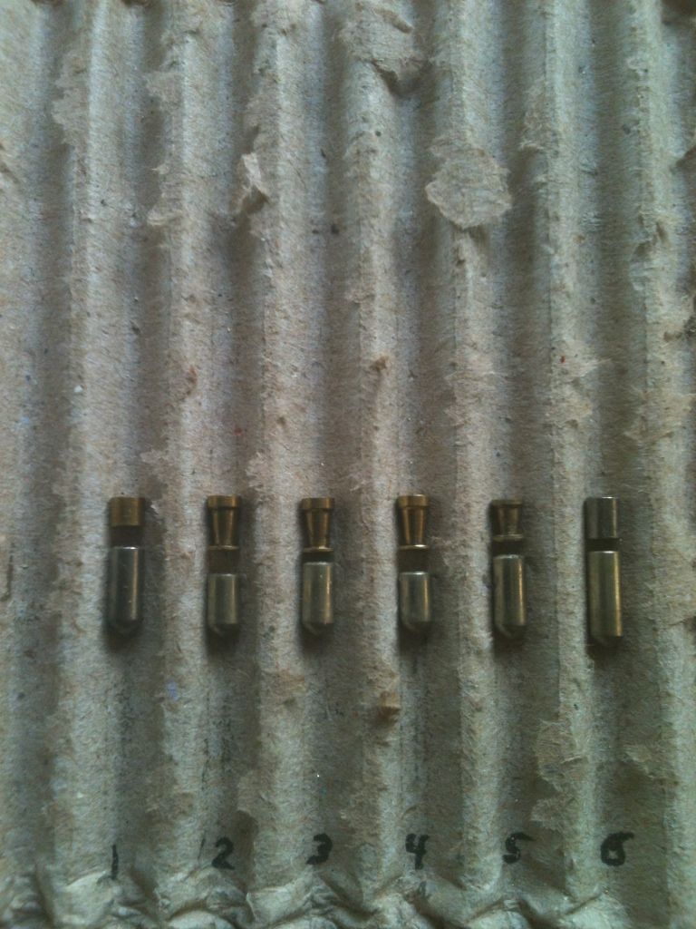

The white ones are originals Vachette spool key pins but the brass driver pins are homemade
like that, the trick is to put enough pressure on the pin to let it rotate free and keep it right in the hole (key pin in the rotor to put it at correct height)
Those homemade pins are pretty effective, difficult to do the difference between a traped pin and the shear line

Thanks :wink:
For finishing i use flat brass brush and low speed but beware the fingers and beware the flying pin if you don't hold it enough :lol:
It was for this training lock (bottom one), actually i made a third serrated.
The key pins are unchanged, the driver pins are now 1,3, 5, serrated and 2, 4 spools
Those locks are are very easy to repin, only two PZ screws for pulling out the rotor (after picking of course)

Postby mikus » 16 Nov 2013 11:27
These i made today from a 3mm brass wire by placing it in bench drill and using some files to shape them
