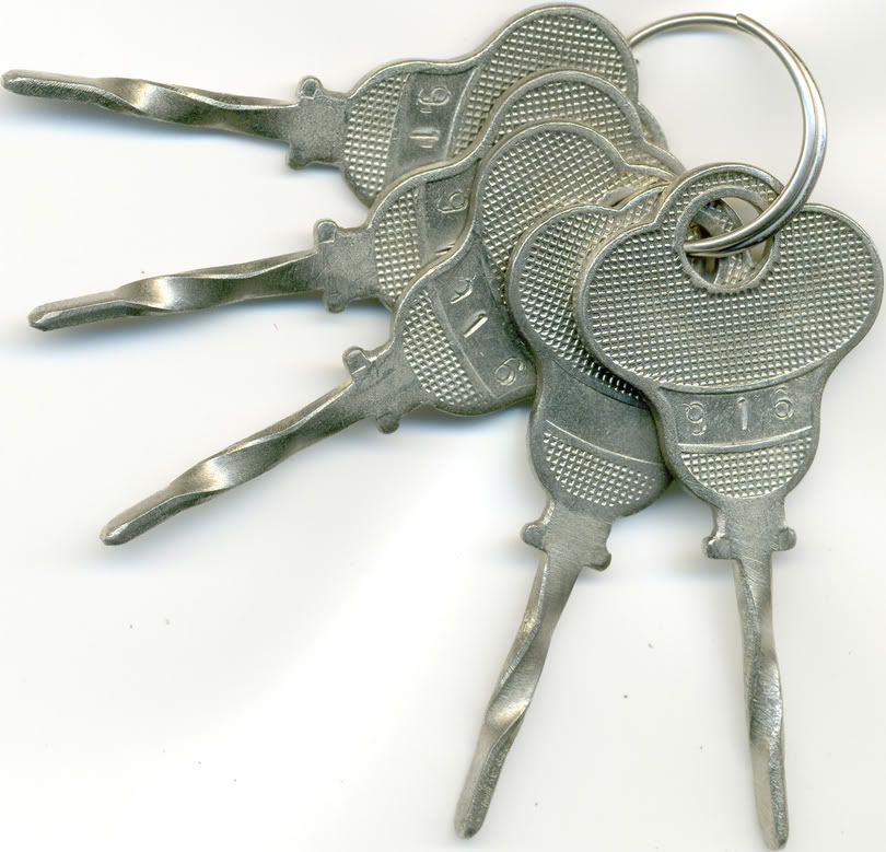

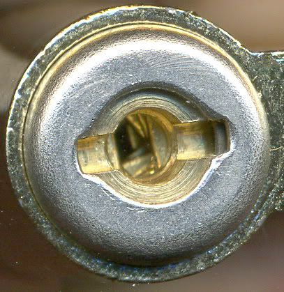

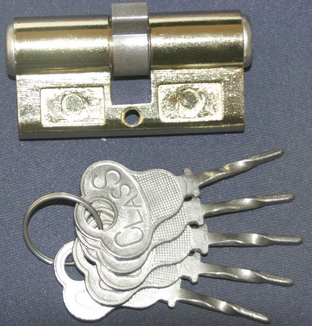

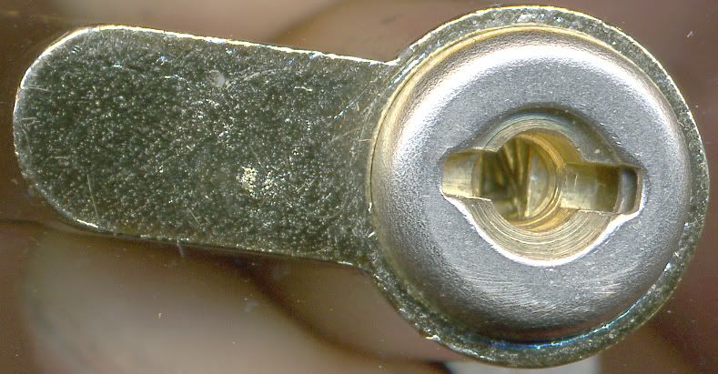

Postby atrix » 29 Aug 2006 3:22
hi all :D
new foto :)
