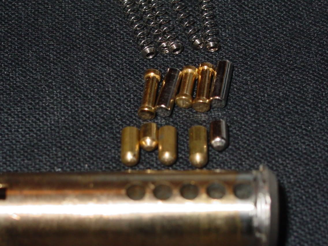

Well just took my America 1105 apart and thought i'd share the insides
http://i173.photobucket.com/albums/w54/l1l_mike_l1l/IMG_3670.jpg

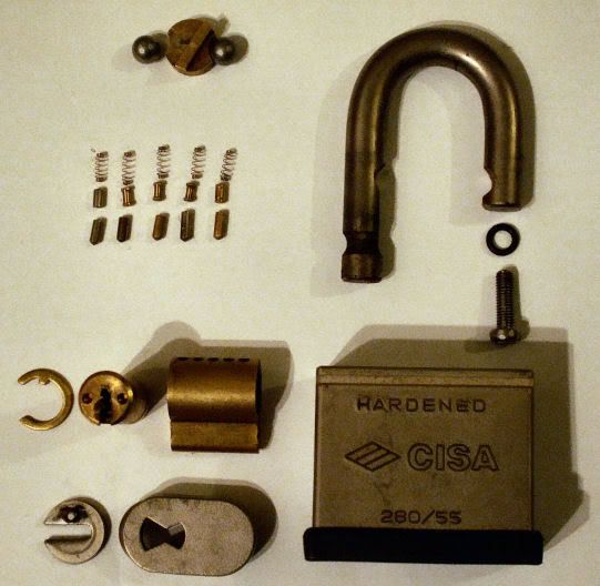

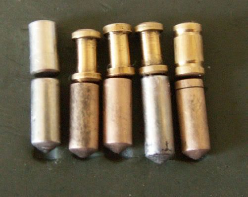

Postby cjames73 » 24 Mar 2007 7:22
this is my CISA 280/55
a close up of the pins...

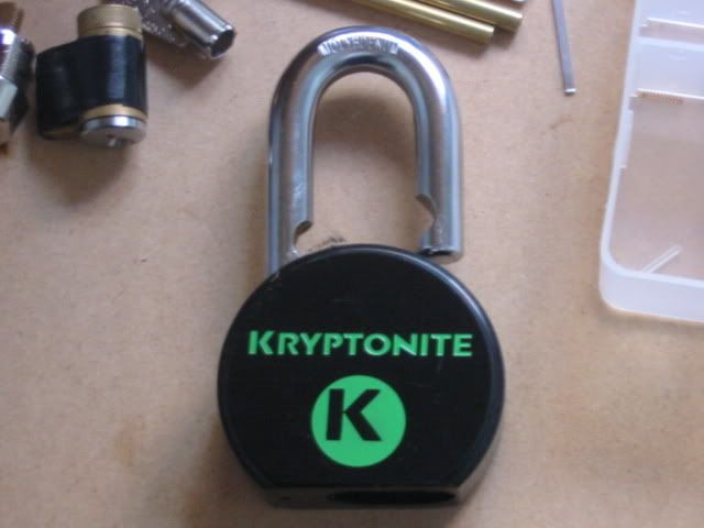

Postby cjames73 » 2 May 2007 9:01
never knew Kryptonite would have so many security pins :shock:
i'll have to get myself one to try now.
cjames73
Posts: 699
Joined: 27 Dec 2006 22:33
Postby NIC » 2 May 2007 9:23
Don't waste your money !!! Get yourself a American (1105,5200) , just something cheaper. I paid 45$CAN for it, and it has the same cylinder has an American 1105.
