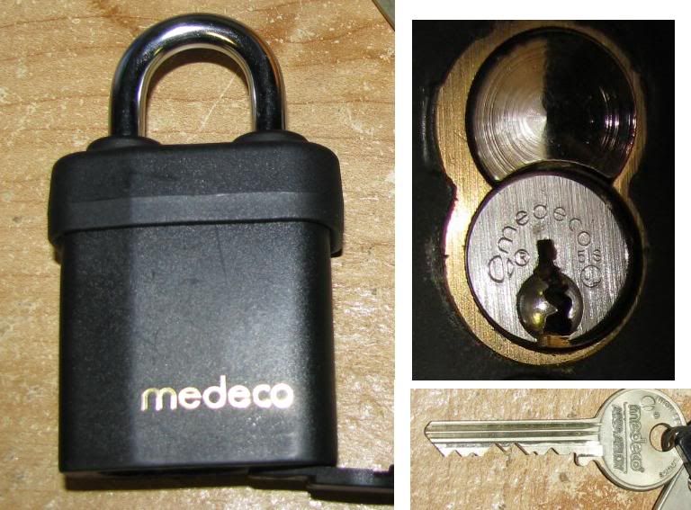

Rift wrote:Also I was under the impression that the key for this lock would be the round one shown in JK's website not the big square one that I got. Did they just get rid of that design and now only use the big square ones?
Thanks rrkss ill see if I can dig up some of that information.
Rift
Medeco uses different keyhead designs for different keyways. For example I have a medeco padlock manufactured in 2009 with a round keyway. The core in this padlock is biaxial which traditionally uses square keys.

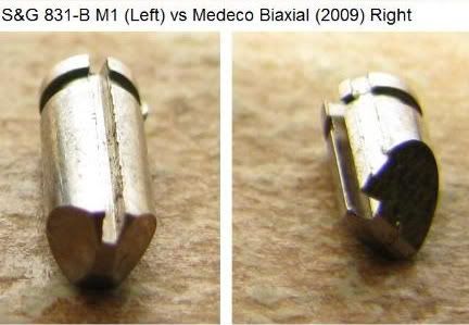

As for a side by side pin comparison of classic vs biaxial, here are pins taken out of a S&G 831-B (Medeco Classic) and my Medeco padlock (Medeco Biaxial) so you can clearly see the difference.

Ahh I see. By round keyway what exactly do ya mean? Forgive my ignorance I think I understand what you mean but not totally sure. As far as the pins yeah my pins are definitely the ones on the Left so none Biaxial. Also no ARX like I had previously thought.

Round keyway? Oh oops I made a typo, I meant round keyhead. Most of my medeco biaxial cores I own come with square keyheads. This specific padlock has a round keyhead.
Yes biaxial is the stamp on the left of the keyway the thing that looks like a circle sliced in the middle.
