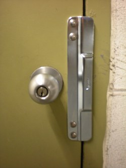

You're right though, cylindrical latch locks by themselves are a bad option. We always recommend using latch guards with any standalone cylindrical latch we install. It's a requirement for us on high-end locks.

I think the problems encountered with deadlatching cylindrical KIK\KIL sets mostly fall into the categories of poor maintenance, poor installation or poor lock mechanism choice.
