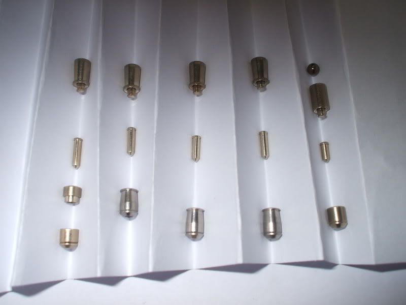

The Ingersol London Line cylinder is an MTL interactive, but it has a different profile and a snap secure hardened steel strip in the centre of the cylinder.

impressive pin setup, suprised i could pick it to be honest
The first pin in the cylinder is always going to be high lift due to the floating pin element.
Also note the back pin is some crazy split pin in pin

Ho-lee crap. That pin setup is incredible.
I know it's beyond my present abilities, but man do I want one!

I did my homework on friday evening :)
I was lucky to pick it before seeing your picture of the pins, otherwise I could have been worried! Impressive setup.
I picked the outer pins with the big one and then the inner pins with the micro diamond and hook.
Could the split pin be a sort of bump protection?

Postby Rickthepick » 10 May 2010 3:19
well done.
not sure on the purpose of the split pin but i wonder if it would separate enough to create an additional sheer line :idea:

Postby femurat » 10 May 2010 4:21
The pin has a section that suggest me that it isn't possible, but this is just a wild guess.
If you're really curious why don't you try it yourself? Put in just that pin, in the second chamber I suggest, and then test your idea!

Postby datagram » 10 May 2010 10:36
Rickthepick wrote:well done.
It's a Split-D pin used to prevent bumping. Standard as far as modern Mul-T-Locks go, but it is good to see it in the field. Again, more information on Split-D and all the other pins used available in the Mul-T-Lock: Design and Security paper. I will attempt to stop whoring that paper now.

Postby Squelchtone » 10 May 2010 11:50
Nice job guys! I like your idea of using a folded piece of white paper to show the pin stacks. It photographs really well.
