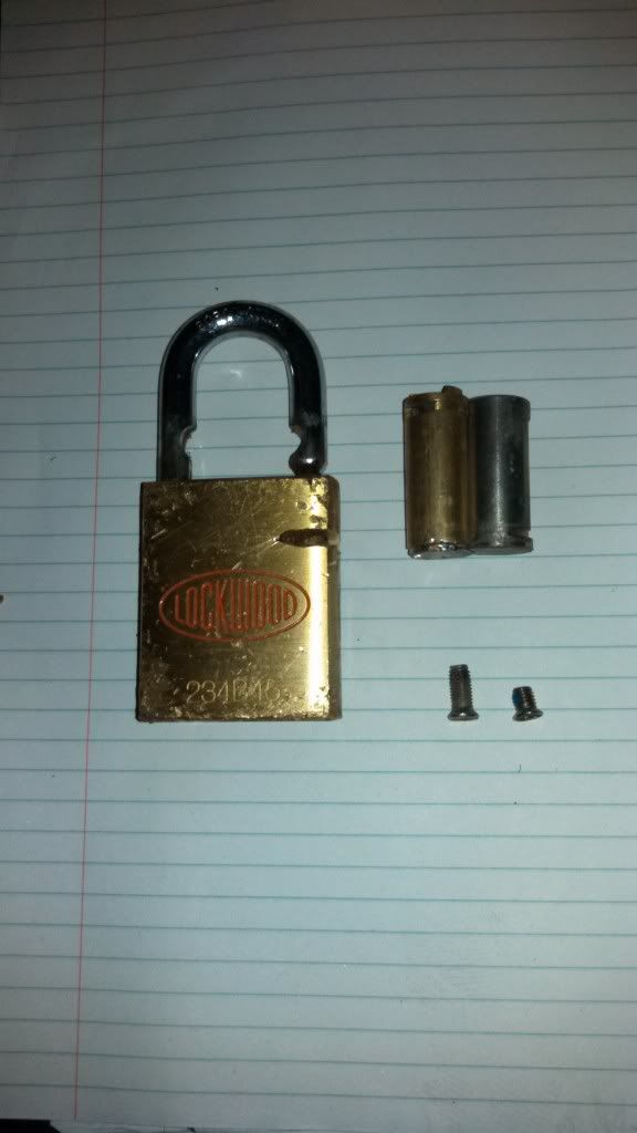

Did alot of smackdowns and compressing the shackle, the screw moved in quiet alot but it seems that I am still about 1mm from the target, so close but so far! Can't give up now so something is going to have to give.

Looking at the photos you linked to, I can't see any engagement between the cylinder, and the retaining screw. The screw only engages the hardened cylinder retainer, and this pulls the cylinder into the correct depth. As such, you should be able to push the cylinder into the correct position, even if the retainer is sticking out.
If the cylinder won't push back, it's probably because the slot on the tailpiece isn't aligned with the piece which engages the ball bearings. Turning the cylinder whilst pushing it back should allow the pieces to align, or possibly just turn the bearing piece with friction.
If this doesn't work, IMO something else is going on - I don't see how the retaining screw can stop the cylinder seating fully.
If none of this helps, you can drill a small hole through the brass body near the part which turns to lock the ball bearings, and use a probe or pick to rotate this part. Holes in brass repair very easily, just tap in a very tight fitting plug cut from round stock, then file flush.
NB Mods: This isn't a destructive entry technique, as it will only work on a padlock with the plug disengaged from the ball bearing cam, or one where the key is present!

I have thought the same thing about the lock cylinder possibly being able to float freely inside the lock. He may have to grind off part of the bow of the key (but leave the shoulder alone) in order to get the key deep enough past the retainer to fullt engage the cylinder.

i reckon what's happened is the ball bearings are lodged halfway between the shackle and the locking cam and are binding there. that would explain why it is still locked and going nowhere. Stick the padlock in a vice shackle down, taking pressure off the ball bearings and smack the S*** out of the plug. If the key still turns now, before doing what I just said, turn the key and snap the head off then smack the F*** out of it!

Yep something had to give, I filed down to the screw through the side of the padlock and turned it that way. I was suprised myself how much difference there was between the screws, late night sessions really kill concentreation.
I was thinking to make a cut away lock so now this gives me the perfect excuse :)
