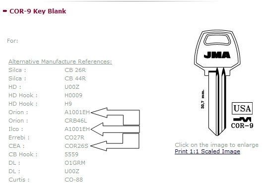

LockDocWa wrote:Corbin cylindrical / deadbolt or any large format key will use the 14MC.
I don't think so... e.g. COR26S
If and when you get an HPC1200, all the info is on the cards.
I have a HPC 1200...

Postby LockDocWa » 8 Mar 2013 21:45
Post a photo of the COR26S.
Off the top of my head I don't know what that is.

Postby LockDocWa » 8 Mar 2013 22:04
This is a CO26, is this close to what you are talking about??

Postby minifhncc » 8 Mar 2013 23:49
LockDocWa wrote:Post a photo of the COR26S.
In Silca, it's blank CB44R or CB34R.
https://www.drlock.com.au/store/silca-k ... &order=ASC

Postby LockDocWa » 9 Mar 2013 11:54
From what I've seen ,
the CEA COR26S = Orion and Ilco A1001EH
The A1001EH uses the same card as the rest of the 1001 series. CW-14MC
SEE CARD #13
Can we put this to rest now?
