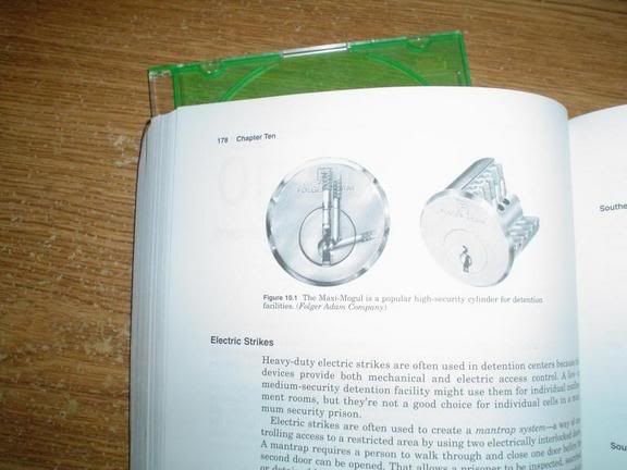

In The Complete Book of Locks and Locksmithing by Bill Phillips (5th edition), they have a picture of a Folger Adam Lock called the Maxi-Mogul with three different shear lines. Two side by side on the top, and one coming from the side at an angle. It looks very difficult to manipulate to say the least...

Postby lockedin » 25 Sep 2005 0:44
Here's a pic:
