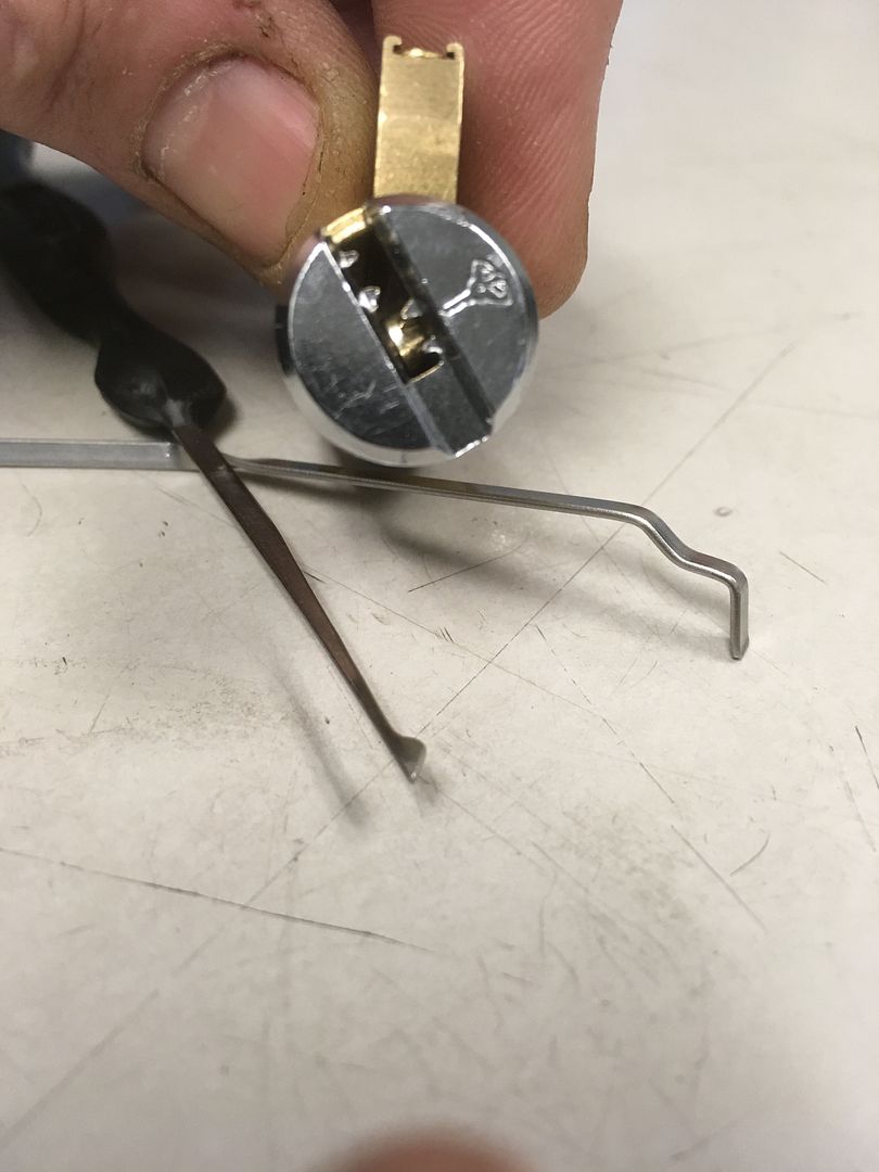

Postby adi_picker » 13 May 2017 6:40
Looks like its been a banner day for MTL! A couple of days back I received a parcel from tpark, containing amongst others..
A MTL 7x7 housed in a G55P..
And a MT5+!
The MT5 sliders were a bear to pick, definately not a 4 minute video for me like some of the ones I have seen, but an open none the less. I started by trying to pick it CCW, as this bound the top pins first, which I am used to, and I could easily get past them into a deep false set but I couldnt get the tensioning for the sliders correct. I must have picked those top pins 50 times today and then flunked on the sliders, dropping the top stacks back while slacking the tension. About an hour ago I started to try and pick it CW, which bound the sliders first, and I found them much easier to set. Other than them, it feels and acts exactly like an Interactive, although the pins themselves are a litter smaller, so I found I couldnt be as brutish with them. They required a bit more precision to not mash the inner and outer at the same time.
Thanks heaps tpark, I hope you enjoy what I sent you in return!
Also, peterwn, I also have never seen a JD in Aus, nor a JL or JM, which I agree would be the Maison profiles. That said, I got that info from an MLAA doc, so I assume its correct, perhaps they never bothered to put the JD into production? Could be a rarity for one of us to find :)

Good job getting the MT5+ open - that's not an easy lock. I too had the issue with pins dropping when trying to open it CCW, but the other way is better. I never knew the pins were smaller - I've had them apart, just not at the same time.
