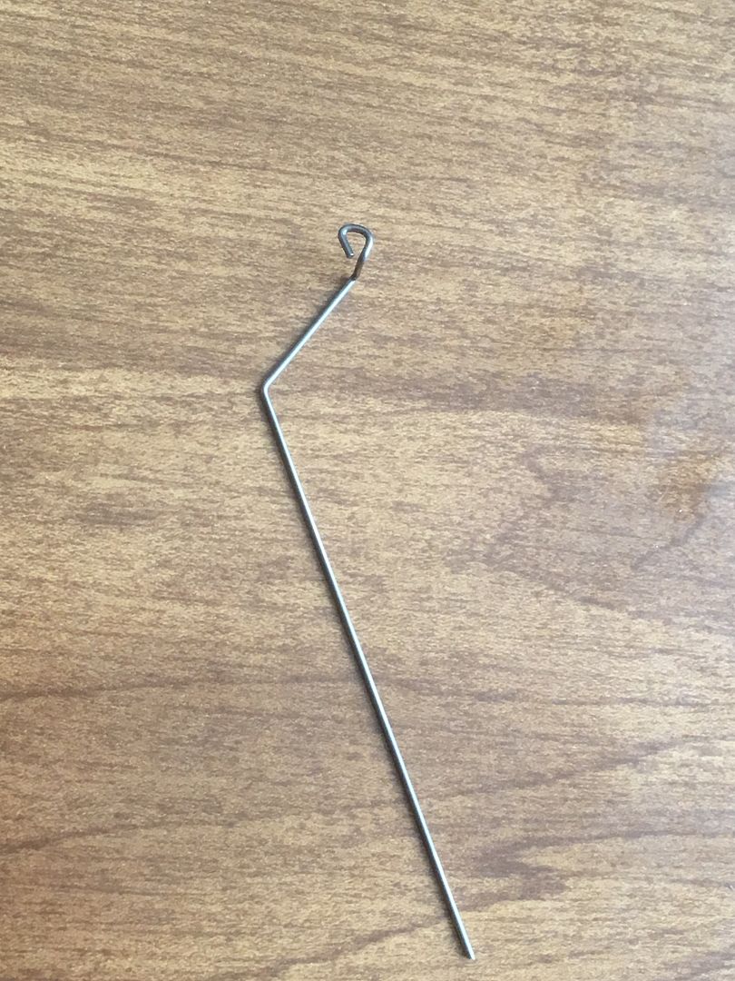

Postby GWiens2001 » 30 Dec 2017 11:28
The tensioner only needs one wire. It looks like this:

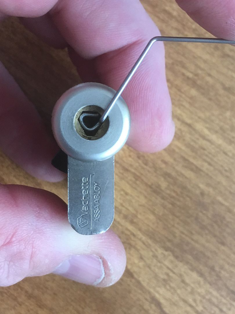

It fits in the keyway like so:
You can stick a hook pick in the hole in the middle and use the corners of the triangular keyway to hold the back of your pick steady while you pick the pins on the flats of the triangles.
Is your Vachette AXI Home a cutaway?

Postby greengrowlocks » 31 Dec 2017 0:39
Aww that makes much more sense than what I thought you did. For some reason I thought you used two 90 degree bent wires with some sort of spacer in between them. I like how yours works, it is probably easier on the keyway compared to what I made. I'm afraid my tensioner may deform the keyway if too heavy tension is applied or for too long.
Anyway this is what my tool looks like now. It fits well and there should be enough space to work with. I'll being trying to pick the lock tonight. If I can't get it to work I'll try making a tool like yours.

Postby GWiens2001 » 31 Dec 2017 9:30
The tension should be very light in order to pick the lock. Heavy tension will bind the pins too tightly. There are also spool pins.
