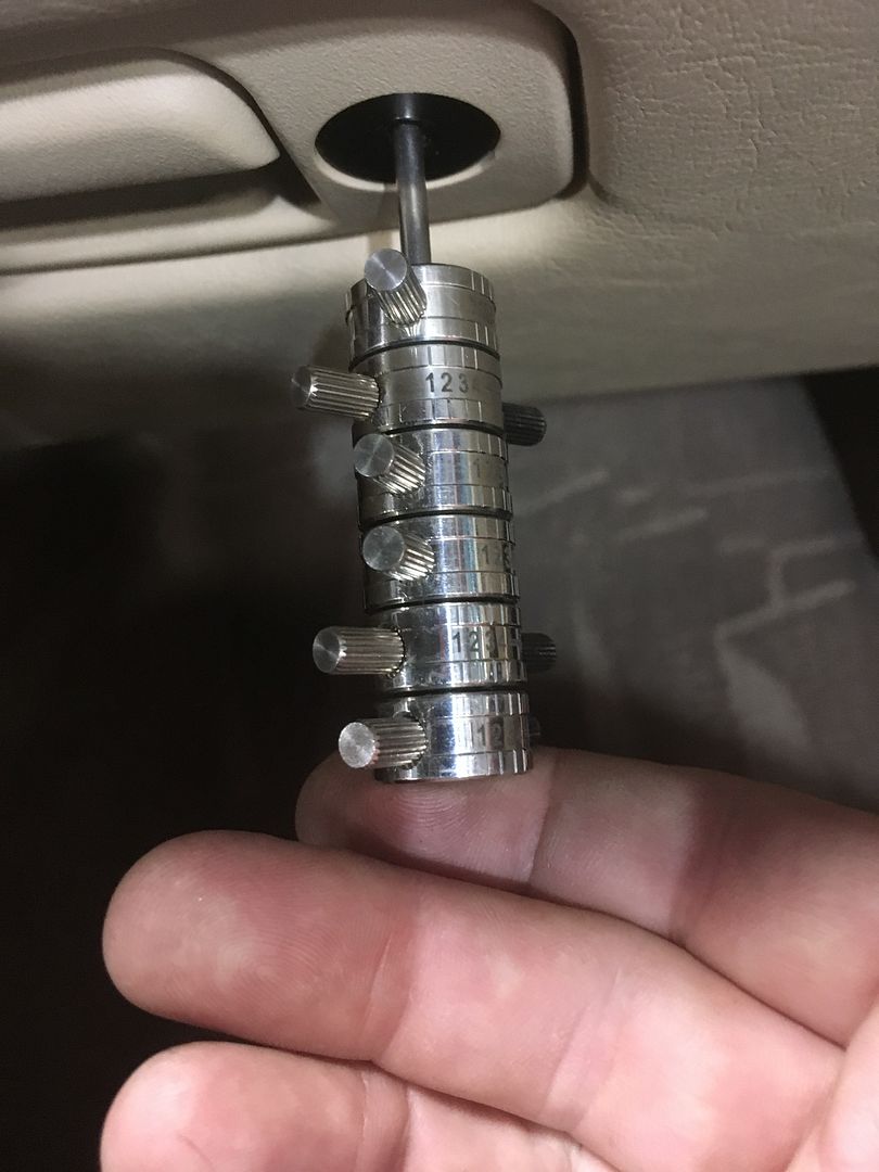

Postby GWiens2001 » 15 May 2018 20:02
Glove box on a Jaguar.
Then keyed it to match the rest of the car. :mrgreen:

GWiens2001 wrote:Glove box on a Jaguar.
Nice work, I have a Tibbe tool, doesn't seem as nice at that. Can't wait to get a chance to use it, Likely have to check ebay again, I think I have seen for about $15 cylinder with keys.

Postby GWiens2001 » 16 May 2018 21:00
Thanks, Stratmando. Still want to get the 8-disc Jaguar pick when the funds free up. Luckily, this was a newer Jaguar that uses the 6 disc Tibbe locks like the Fords.
