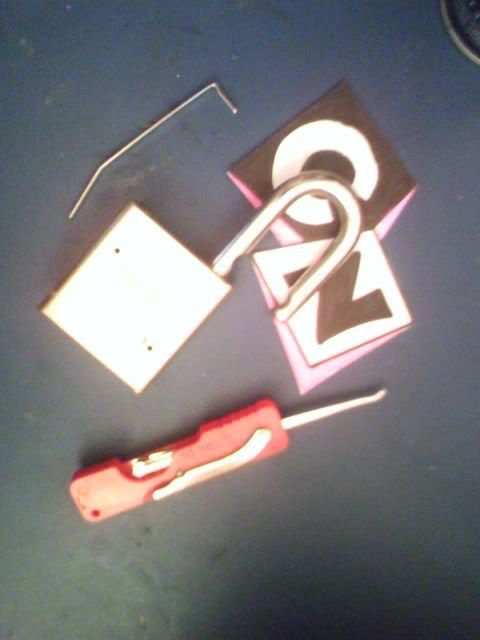

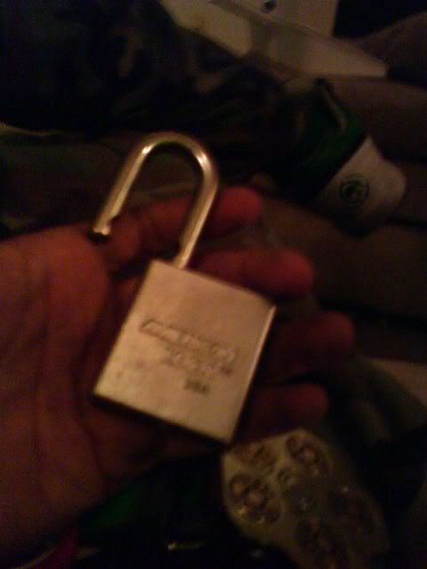

Postby CartooN_NetworK » 31 Aug 2007 1:43
Funny thing, Ive never checked out this thread till today when I caught the 5200 series. Today my friend let me have a lock he had. "hmm this looks like a nice lock." took a while to pick...I wondered if it had security pins in it...had my jack knife in my pocket and picked the lock in my lap.
I finally really put some light on it and look at it while Im picking, and notice the first pin was getting stuck, and I wasnt sure if it was because it was weathered or if was just the lock. I turned the lock so the pins were upside down and gave it medium tension...got it open. It took a bit of tension to fully open it with my jack knife tension tool; then I pulled it open and presto.
I found it helpful to pick it with the pins facing down and a light/medium tension; and that was with a short hook on a jack knife and the tension tool.

Postby CartooN_NetworK » 31 Aug 2007 17:35
JackNco wrote:well I think most members would be reaching for the foldout sets last but if it works for you than thats all that counts.
John
well I wasnt at home, so all I had on me was a jack knife...If i had a regular pick and tensioner available, Im sure it would have been 2x as easy. 8)

Postby CartooN_NetworK » 1 Sep 2007 5:46
vrocco wrote:You are a better man than I. I am still fooling with this thing. I can't find a real good tension wrench to fit into the padlock. I am gonna try and take it apart and just pick the plug out of the padlock body. Let's see how that goes.
I measured the tension tool I used for ya, because this one seems to sit almost perfect in the keyway: the head is 13x4mm on a 90 degreee bend (handle as long as u want), and the metal of the tension wrench is right at 1mm; so anything give or take 5 more mm should be golden man. hope that helps. give us your status when u get it or if you get stumped. 8)
