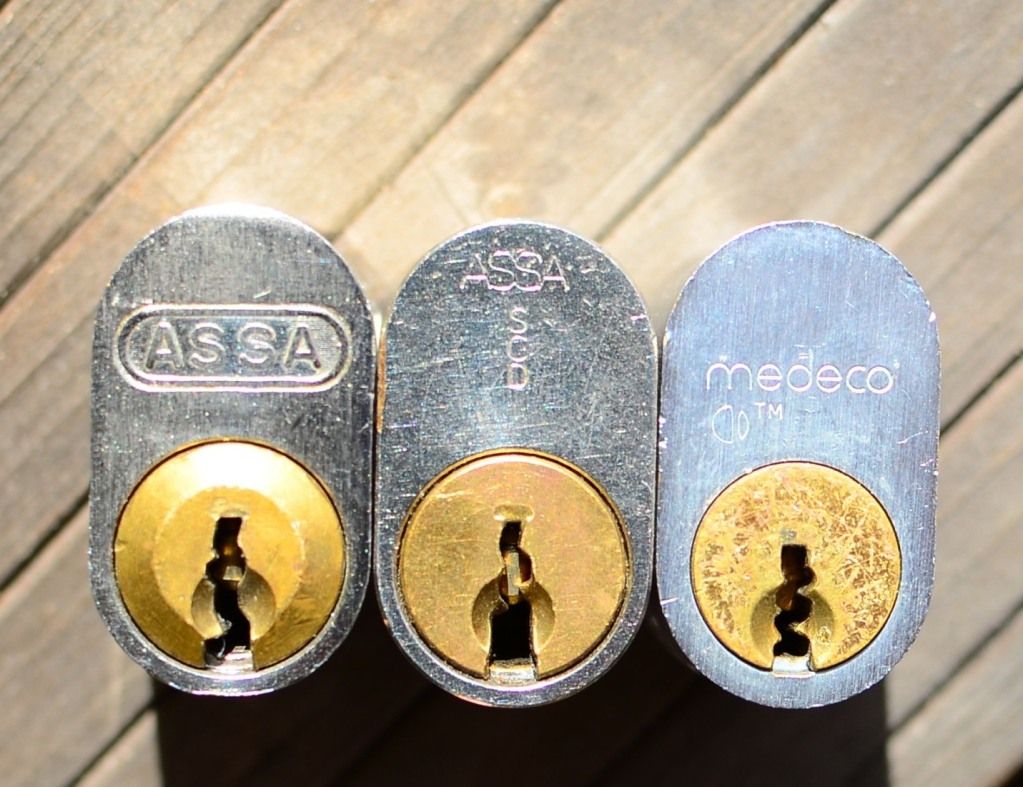

Postby zeepia » 8 Aug 2012 1:54
Hi,
found these from a fleamarket at monday. No keys and wondering what are these?
I just received a package containing assa twin combi, assa 700 and assa d12 so those are familiar but these are with different keyway.
And that´s the first medeco I´ve ever seen here in Finland :D
haven´t taken these apart yet but when starting to pick then maybe coughonlyonepinatthestartcough
zeepia

Postby Wizer » 8 Aug 2012 9:00
Nice finds, zeepia!
If those Assas have 7 pins, I believe they´re 700-series, 6 pinners are 600. (correct me if I´m wrong).
And a Medeco Bi-Axial. You can tell the model from the logo on the face of the lock. 5 or 6 pins? Very sweet! Never seen an scandinavian oval cylinder with a Medeco plug.
Let us see these in the "What did you pick today" - tread... :D

Postby zeepia » 8 Aug 2012 23:25
Left one doesn´t tell me how many pins there are. No signs at all. Does that mean it is an older one?
Middle one is 7 pin, similar as yours.
And Medeco is 6 pins. Nice feature in Medeco compared to Assa that you can take pins out straight from the sylinder with a 2mm hex key.
Is there a lot of different keyways in same series, say 600 and 700?

Postby Wizer » 10 Aug 2012 10:34
zeepia wrote:Left one doesn´t tell me how many pins there are. No signs at all. Does that mean it is an older one?
And that other thread must wait a little... :oops:
You can tell how many pins there are by simply inserting a pick or a straight probe all the way into the lock. Now lift all pins up with your pick, and slowly pull it out. Listen to the clicks the pins make falling down, count them. Allso its allways nice to feel around with a hook in the lock. Even if the lock is too hard to pick, you get to practice feeling the pins.
There are atleast 100-200 available keyways for Assas. And I bet there are atleast as many protected keyways that you can´t find blanks for.

Postby zeepia » 10 Aug 2012 12:48
Thanks, I did know that but picks were at least 4 meters away and it rained outside and... :oops:
also that has 7 pins.
I wouldn´t want to be a locksmith when customers come to dublicate their keys with very exotic keyways. It seems that you can´t have all the shapes available at the wall.
