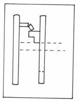

Postby capt.dunc » 22 Dec 2016 10:34
a guide for warded door locks
Warded Locks, below are two examples of keys for warded door locks
on the left we have an iron key for an antique lock, and on the right a modern steel key for a union lock. both of these are real life keys in current use in the uk, and both of them are using the same technology to provide their security, wards. (note there will also be one or two levers in the lock to prevent the bolt from freely sliding, many lever locks (from 3 to 9 levers) may also employ warding of some form. in general if the majority of the security is being provided by warding i would consider it a warded lock.)

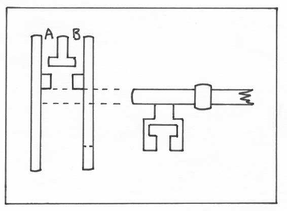

What is a ward?
a ward is a piece of metal built into the locks design which prevents similar keys from fitting into, or turning fully, to open a lock.

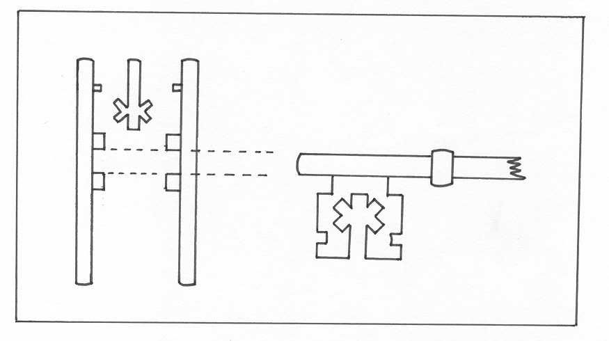

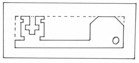

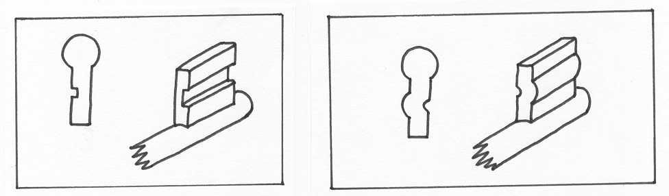

Keyway wards (case wards, u.s.)
an unusually shaped key hole which prevents an incorrect bit from entering the lock.

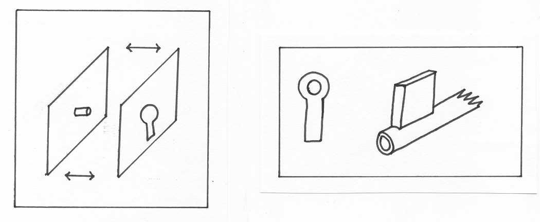

Key post
this form of ward is only found on one sided locks, ie. padlocks and chests. the post is attatched to the back of the lock case and reaches into the keyway at the front. the key for this type of lock has a hollow stem which accomodates the post when in use.
occasionally you may have a key and lock which have stopped working, try cleaning out the key's stem hole to ensure that the key can enter the lock fully.

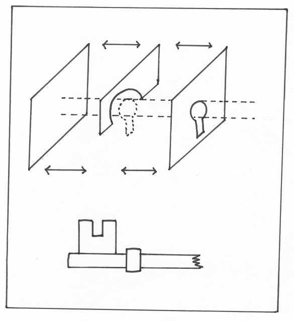

Partition wards
a full partition, or dividing ward, is like a second face plate set inside the lock.
note: the ward touches the key stem.
Partition wards can also be partial.
note: this ward will only block the centre top of the key bit.

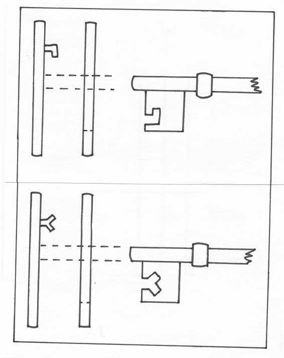

Pin or point wards
small pins or raised points on the inner surfaces of the lock in the path of the key bit.
These may also be attatched to one or both sides of a partition ward.

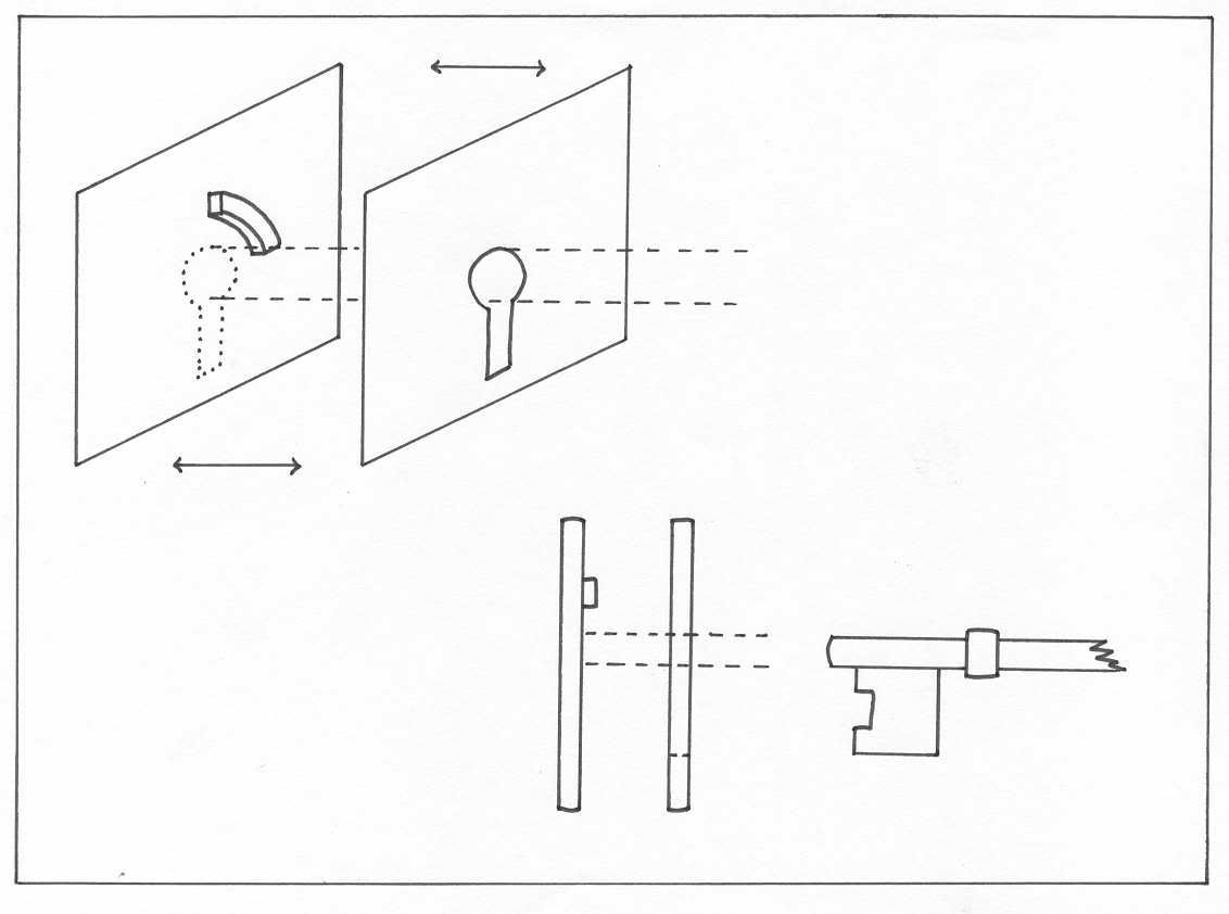

Track wards
an obstruction which is continuous along the path of the key bit.
the example above, a continuous ward around the top of the keyway, is also known as a collar ward and is found in many lever locks.
Partial track ward
a semi circular ward section
this is less prone to damage than a pin ward, and easier to make by hand than a full track ward.
not all track wards are rectangular in cross section;

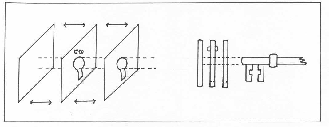

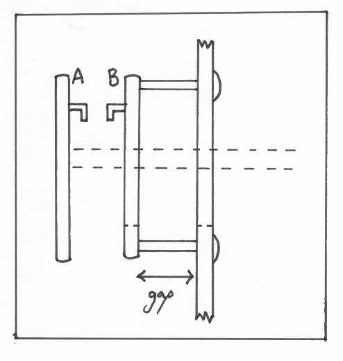

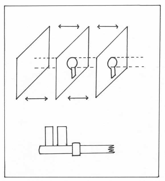

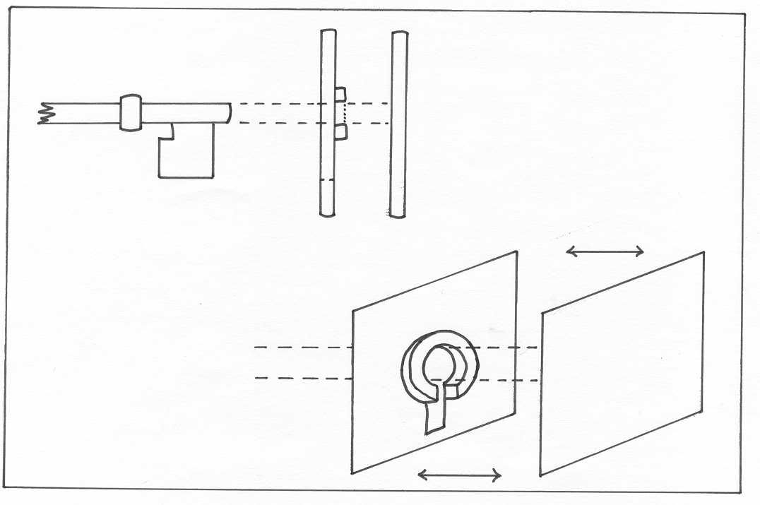

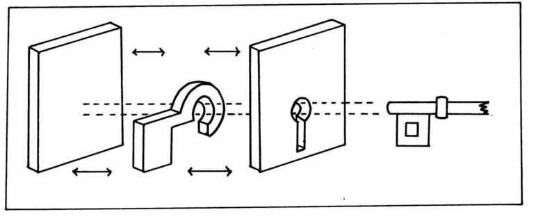

Free floating track wards
These are semi circular wards secured to the lock at one end. the key "threads" onto this ward then cannot be removed untill the lock is reclosed. like modern key retaining locks, this is usually found in higher security applications, ie. old cell doors and safes.
All of the above wards can be used in various combinations for greater security, and all of the above have been shown as single sided locks. have a look at some old keys and think about how the corresponding locks may be constucted internally.
the lock above may have pin wards but they could also be tracks. it may have a partition with tracks or it could be floating track, and hence key retaining, keep an open mind.

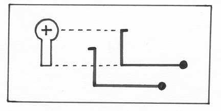

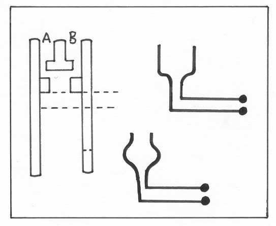

Picking

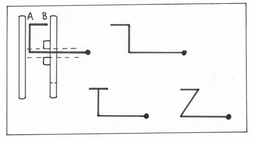

What do we need? for the basic lock model we need nothing more than two "L" shaped wires, one to slide the bolt accross (at A), and one to raise the lever or levers to the correct height (at B)
and these two basic picks will still do the job in a lock with simple warding
you may even be able to open the lock with only one wire, raising the lever and throwing the bolt in one move (as you would with the key).

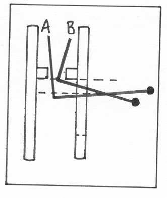

however neither of these will work in the folling lock, with "L" wires being blocked by the side mounted wards and "one turn openers" being blocked by the partition
we'll need specially shaped wires for this lock.

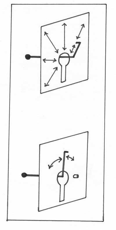

feel;
use straight, "L" shaped, shallow buttonhook and reverse buttonhooks to probe
it may help, with complex warding, to stick a couple of post-it notes to the door and record where you feel the wards.
use the straight probe to gauge the lock's depth and the depth to any partitions it can reach.
use the "L" shaped wire; to feel for bolts in the metal box example above, to check for partial partition wards, and to feel if it's possible to move the bolt and levers with two "L" wires.
use the tips of the buttonhooks to feel out radially accross the insides of the fornt and back plates of the case, as well as both sides of any partitions.
then use the flat sides of the buttonhook probes to sweep for pin wards which are easy to miss.
now armed with a mental picture of the wards you should be able to select, or make up, a wire or pair of wires to bypass the wards and open the lock.
