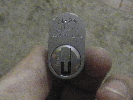

Postby Chrispy » 6 Nov 2005 6:12
If anyone has an idea on the best type/design for a Bi-Lock tension tool, please post your ideas here or PM me.
See below for the shape of the keyway.
*NOTE: This is only a tension tool, please do not discuss techniques or methods regarding the opening of this lock. The extent of this proposition goes as far as the design for a tension tool, nothing else.*

Postby TOWCH » 6 Nov 2005 12:02
I'd go with either a tight fitting rectange at the bottom of the keyway, or a two prong and place the prongs at opposite corners of the keyway. The first could be made form a ground down allen key, but the second would take some creativity.

Postby skold » 6 Nov 2005 14:13
TOWCH wrote:I'd go with either a tight fitting rectange at the bottom of the keyway, or a two prong and place the prongs at opposite corners of the keyway. The first could be made form a ground down allen key, but the second would take some creativity.
there is abut a 1.5mm clearance between the bottom of the keyway and the pins.

Postby TOWCH » 6 Nov 2005 14:38
American lock noah? the brand or do you mean locks from over there?
I'm not sure if I understand. So you're saying that taking up that much of the bottom of the keyway, hinders pick movement too much? I'd go with the 2 prong idea, or make a U shaped wrench out of brickstrap then. You can bend brickstrap like that by pinching it between two appropriately sized square rods and bending up the edges with a hammer. You might want to grind down the edges a bit to give your pick some breathing room if it's a tight fit.
