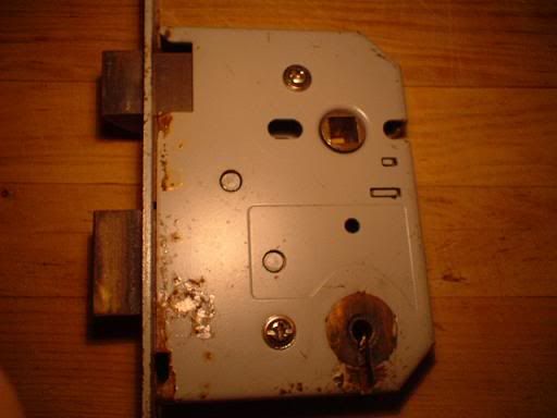

The exterior of a lever lock:
The interior:

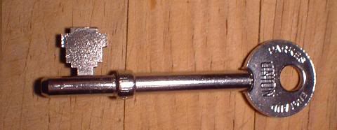

The key:
(Notice the warding pattern near the shaft of the key)

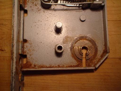

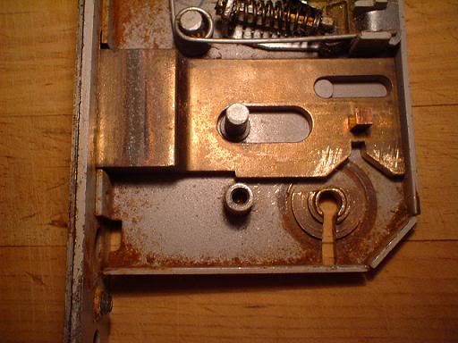

The empty case:
The bolt:

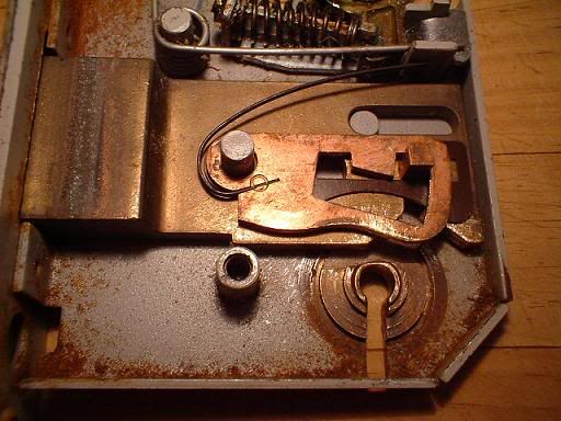

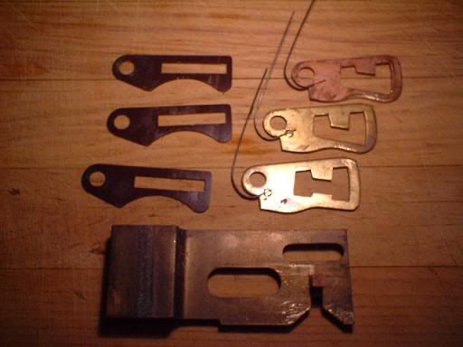

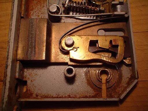

The first lever:
Second lever added:
Third lever added: (notice the protruding fence at the bottom of the lever)
The Three Levers, the Bolt, and the Plastic Spacers

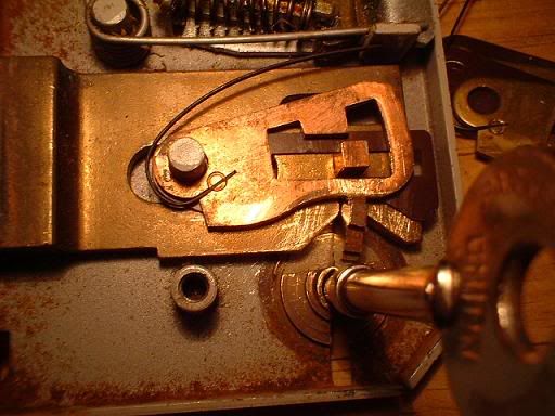

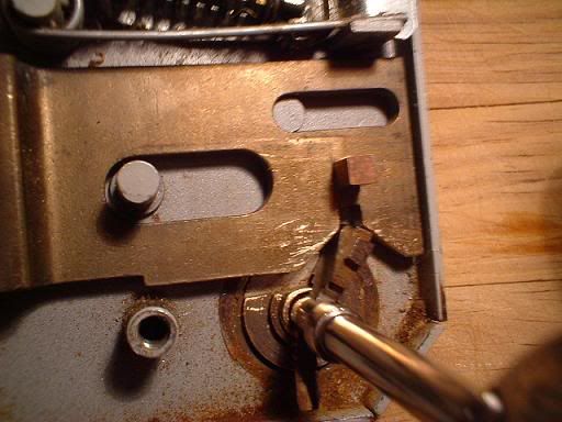

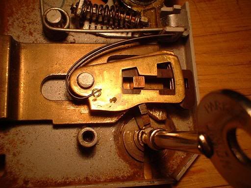

Now you have seen the mechanisms and components of a lever lock it seems fitting to explain how exactly the key operates, and inevitably opens. Despite not being a warded lock, this lock incorporates a simple system of wards which can be noted as the rings of raised metal around the keyhole, and also on the key bitting near the stem.
The key engaging the bolt:

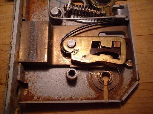

The function of the levers, and also the part of the key which engages the levers should now be apparent from examining the first picture.
The first lever effectively creates a working lock whereby the key with the correctly cut bitting must be used to open the lock – unfortunately such a lock would offer no protection to manipulation. It is only when the second and third levers are added does security against picking occur.

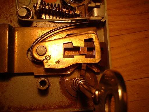

The first lever added and the key lifting it to the correct height:
(Especialy note that the lever has a larger gate than is necessary - this is because this lock is part of a masterkeyed system, and the key which I have shown will also open one or more other locks which are masterkeyed for this system - Briefly, if another key was modified, which did not lift this lever as high by 3mm then the lock would still open, but it would not however open the other locks designed to be opened by the master key. This masterkeying system is not normaly encountered outside this series of locks. The key I have shown appears to be the slave key for this masterkeyed system, because although it lifts the last lever higher than necessary it fits the warding perfectly and would not be able to pass a wide wariety of wards. This needn't cause worry and will not impede picking, but is usefull for further insight into the mechanism)

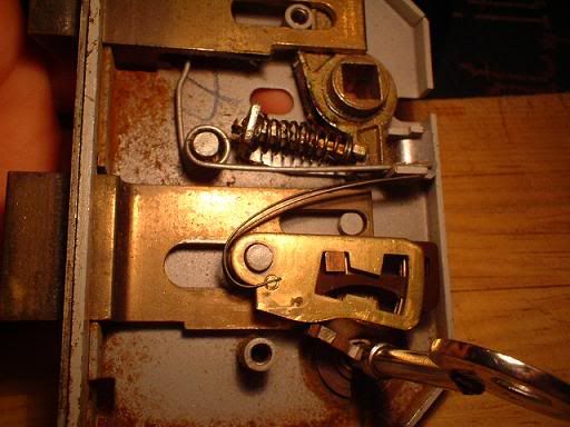

The second and third lever added:
(Note the way the stump has cleared the fences and gone through the gate of the levers)
The bolt being pushed almost fully to the locked/unlocked position:
Finally the bolt has slid across fully into the opposite field and has now effectively either locked/unlocked a door:

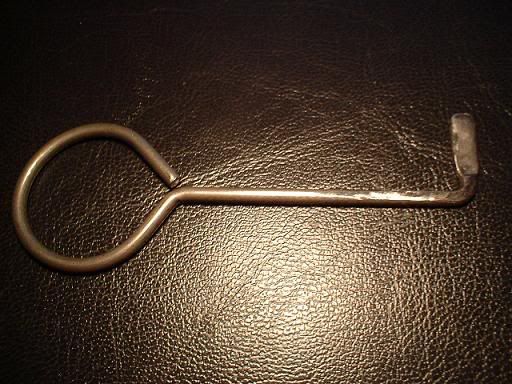

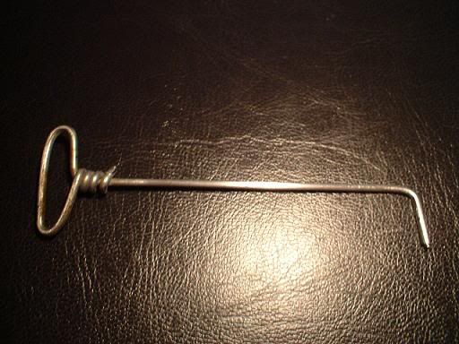

Now the first tool that needs to be made is the tension wire (bolt thrower), and this can be created in a variety of shapes, but as long as the part which protrudes at a 90º angle is long enough to engage the bolt it is long enough. You can simply create a loop with the metal, or use another design for the handle – so long as you are able to apply tension to the levers then you should have no problems. To find a relatively correct size for the tension wire remove the front cover and insert the wire from the other keyhole – so long as it is long enough to engage the bolt then it is long enough. If you have the key you can simply place the wire next to the key to get the right length - minus a few millimetres the highest point of the bitted part of the key should be the size of your wire bent at 90º.
Here is an example of a tension wire (bolt thrower):
The next thing to make is the wire-pick – it follows a similar process to the tension wire, but will be of a different length in regards to the part bent at 90º - it must be long enough to lift the levers to their maximum height. Once again the correct size can be created by using the key - alternatively make it slightly smaller than the bolt-thrower.
Example of a wire-pick:

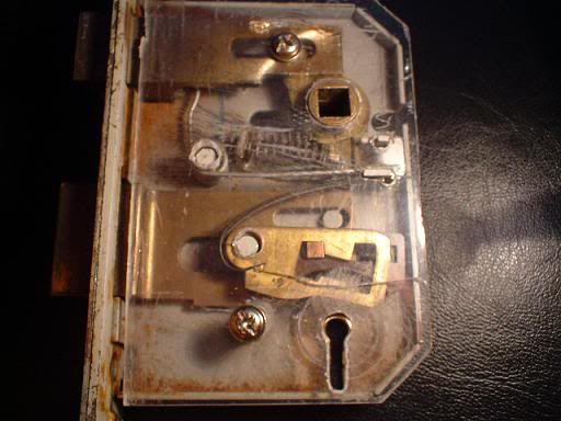

Should you wish to learn more visually you can make a clear cover from plexi-glass – simply copy the shape of the original cover and use it as a template – this is not of great importance, but may help you visualise better after having seen the mechanism when it is being picked.
Clear Case:
Clear Case Showing the Overlifting Process:
(Minus the bolt-thrower)
