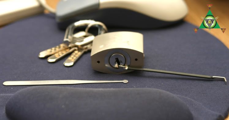

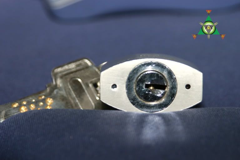

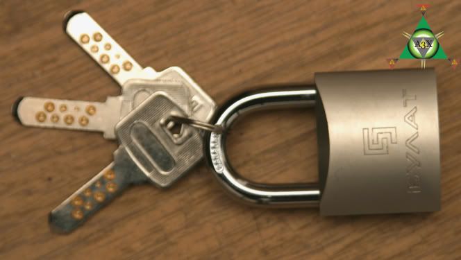

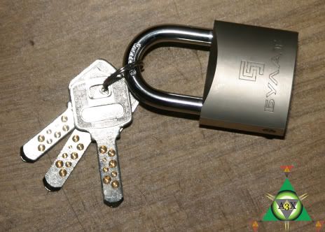

Has bought the new lock like good but I pick it in 10 sec.
Here it:

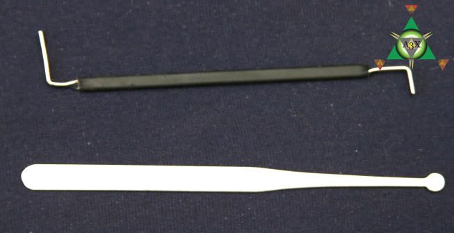

I pick it only vit this tool:
:D :D :D

It does have a rubbish pin combo and i guess your raking it looking at the pick pic but well done,

I have seen some ukranian house keys that look like long papaiz cruciform types of locks, Did ya buy the local lockpicks, that one looks slightly different from the overpriced western ones, but only in esthetics, not function. Welcome to the site. 8)

I'm gonna go out on a limb and guess that he used the side of the pick to press with, using the circle of the ball as a very thin, flat pick that gets good surface contact on the pins. Just my guess (and the way I would have used it on that lock). The pick would be substantially weaker used like this, but with light tension would work fine.

The lock in the picture is called "byoolat" if that helps. Picking a dimple lock is really hard without a matador pickset - you must be pretty good.

Well done to Atrix for picking an 8 pin dimple lock. However, to the people who are amazed by this, I say it's not that remarkable. A lot of these locks have really poor tolerances and for a horizontal keyway lock there's only a short travel on each pin, so sometimes just shoving the pick in is enough to pick it. I very much doubt any individual pin manipulation was required for this padlock. But please correct me if I'm wrong!
