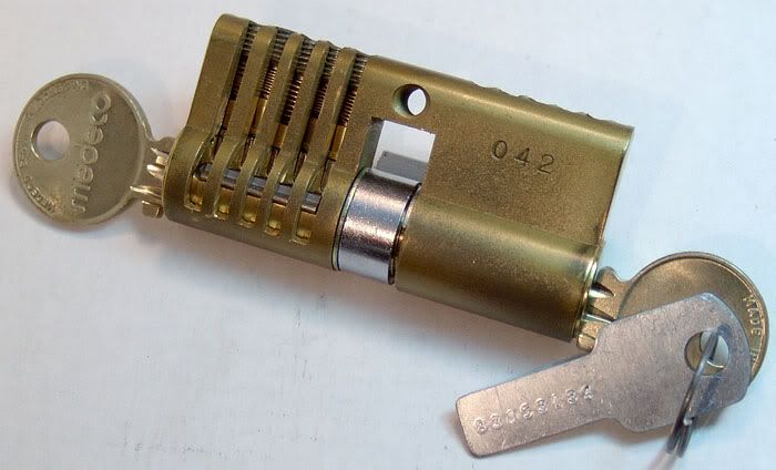

what is the silver thing attached to the key?
Jason13
- Posts: 1475
- Joined: 9 Nov 2005 11:37
- Location: UK
by n2oah » 12 Jun 2006 23:32
Jason13 wrote:what is the silver thing attached to the key?
A code tag.

by ThE_MasteR » 12 Jun 2006 23:36
Nice lock n2oah,
what are those cuts in each pin though ?

by What » 12 Jun 2006 23:40
ThE_MasteR wrote:Nice lock n2oah,
those are the groves for the sidebar.

by n2oah » 12 Jun 2006 23:41
What do you mean? In the key pins? If they are in the key pins, those are the slots the sidebar falls into.

by dmux » 13 Jun 2006 17:00
wow, nice, you made the cutaway?
how did you go about cutting into the cylinder like that, very nice work man

by n2oah » 13 Jun 2006 17:39
dmux wrote:wow, nice, you made the cutaway?
I used a dremel cutting disk and a very small sanding post from a knock-off dremel kit. Mark the lines in permanent marker (it will wash off with a dab of rubbing alcohol) and then start cutting.
