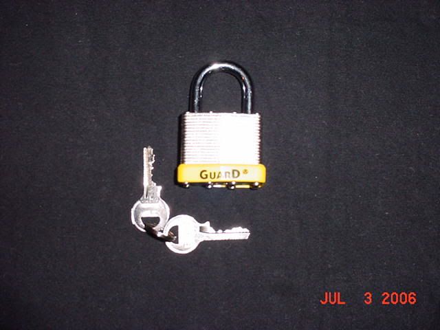

Baught a Guard brand lock (40mm) at the local Family Dollar the other day because the package said Pick Resistant on the front, it was only $2 (US) so it was worth the temptation... :)

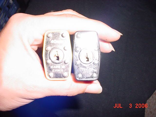

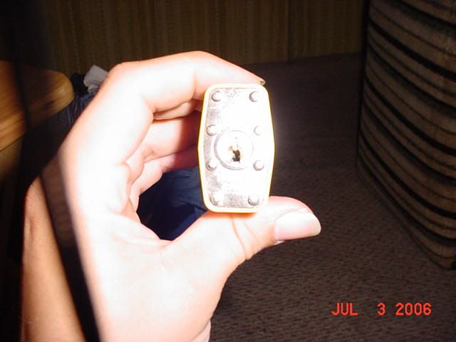

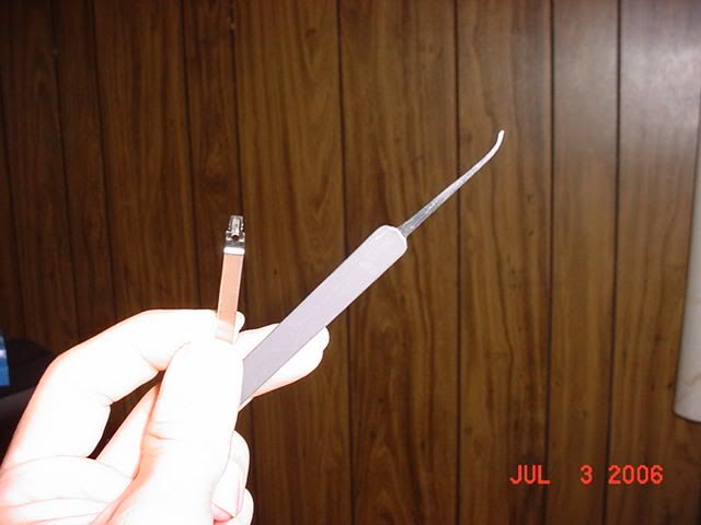

By no means was it Pick Resistant, however all the tension wrenches i had would not fit and rotated 360 degrees in the keyway and i'm not one to put the tension wrench near the first pin. As most know a Penclip can be used but sometimes needs trimming, not in this case so i left it as wide as it was but only bent it to a 90 degree angle.
If anything it was Tension Wrench Resistant... :lol:
If these pictures are clear enough you can see what i mean compared to a similar 40mm Ace Hardware lock.

If they are unclear please let me know and i will try again.

Make a tension wrench from some wiper insert that the bent part is only 2-3mm long, then you tension on the top of the keyway.

Shrub, I have 2 wrenches made from wiper inserts and one of then i flattened out to make wider because I am having a difficult time to find the wider inserts, I would however like to try street sweeper bristles but i live in the country so there is no need for sweepers here. Does anyone have a couple in good condition I can purchase?
So, I have made 3 out of Stainless Butter Knives about an 8th inch wide, they work good and hold their tension very well in all situations.
In conclusion, I will make a 2-3mm T/Wrench today, Maybe shorter or longer by a mm depending if the studs on certain padlocks are in the way.

A small and long flathead screwdriver would also do the trick.

Lockedin, I havent used a mini screw driver bent to 90 degrees since i first started picking locks 2-3 years ago but I have misplaced it. :shock:
I should get me another one, and your right they do come in handy for such an occasion.
