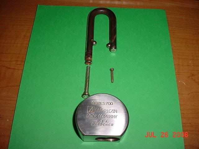

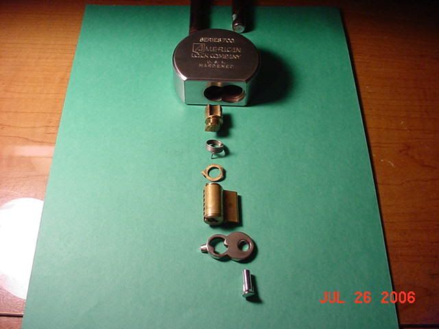

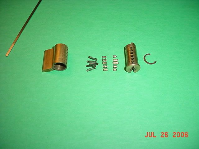

Postby Kaotik » 27 Jul 2006 1:05
Serviced 3 of these today for a fellow and thought I would take some photos of one while I was at it.
I did a search and surprisingly no breakdowns for this lock came up also, hope the pics are clear enough for you guys to make out the pins.
http://i53.photobucket.com/albums/g55/K ... leBody.jpg
http://i53.photobucket.com/albums/g55/K ... erPins.jpg
http://i53.photobucket.com/albums/g55/K ... ernals.jpg

Nice breakdown, but I don't think that's an american cylinder. American locks use spools as top pins, and serrated bottom pins. Someone correct me if I am wrong.

Yick, a little rusty on the ends of the shackle.
Hey, I've got a question: what kind of grease are you supposed to use for the ball bearings and locking area of the shackle? I've seen blue stuff and clear stuff. I use white lithium grease because that's what Ace had and it came in an aerosol can.

Guess what, you are wrong :)
American Lock uses serrated and spool driver pins. That one was probably re keyed at one time because the lower pins are usually serrated when its from the factory. American lock cylinders are not interchangable with Master lock cylinders because of the tail piece at the end of the cylinder. I will take some pics later if im not feeling lazy.
THEY USE SERRATED SPOOLS, SPOOLS, AND SERRATED DRIVER PINS. MOST THESE CYLINDERS DO NOT HAVE A TAILPIECE, BUT RATHER A CAM!!!!11!!!12!212112!

I'm going to second that the cylinder pictured is indeed an American cylinder. American Lock uses both serrated and spool pins as drivers from the factory. I have also seen some that had no serrated key pins, or only a couple in some instances. The lock could have been re-keyed like stated as well.
Still, these are pretty good breakdown photo's.

Yes, the shackle was very rusy and weathered and most of the chrome was worn off (I think that one was used on his front bay door), they were for outside use on his shop building, that one was the worst of them though, the other two cleaned up very nicely with some fine steel wool and a little 3 in 1 Oil. As far as lubing up the ball bearings, the sliding side of the shackle and Actuator I like to use Lithium Grease (the heavy bodied formula in a can). The spray I will use anything with a PTFE in it (the can of Liquid Wrench I have works well for just maintaining locks on a periodical bases.
That lock I posted and one of the others were KA and the third lock was KD, so yes he had it repinned.
