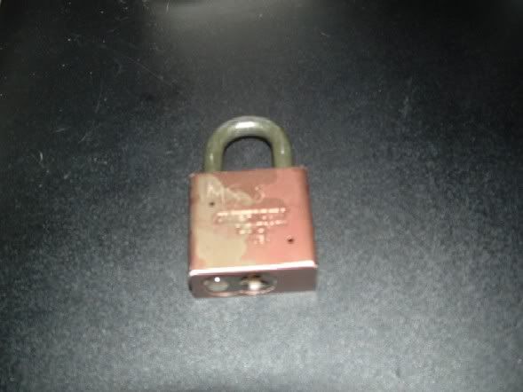

Postby GSA_DENIED » 14 Aug 2006 4:16
Anyone Picked at a Military style 5200 Series Padlock. Locally Purchased on any military installation at the PX or SHOPETTE. I have one that has no key and I have tried to shim with no success(possible that shim was operator error). Back pins will not stay picked while picking to front. I have tried back to front, front to back, feathered tension to extreme tension, NO LUCK back 2 PINS WON'T SET.
ANY KNOWLEDGE WOULD BE GREAT

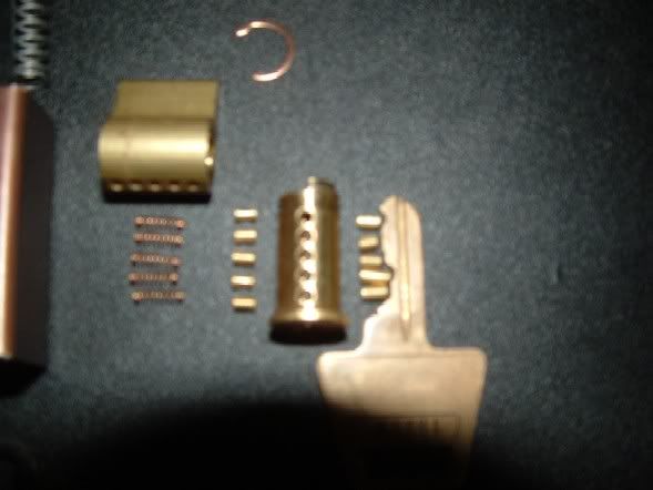

I found a key to one of my old 5200's and so i took it apart and wow.
This lock to me is absolutely amazing. 5 pin tumbler with Serrated bottom pins and 3x2 Top pins 3 serrated and 2 spool, not even to mention that it is impossible to shim due to the dual ball cylinder in the top of the lock which holds the balls in place while the cylinder is in the locked position, when the key is inserted and turned to the unlocked position the balls are allowed to retract into 2 grooves on the ball cylinder, keeping it locked and un-shimable. Looks like the only way to open is picking it, I will post some pics

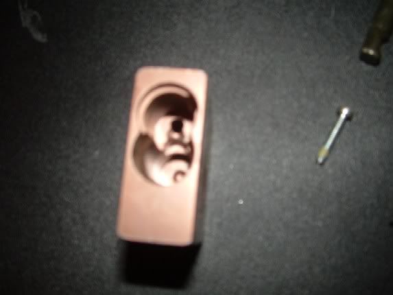

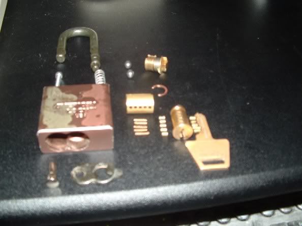

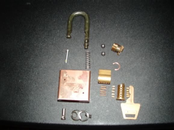

Postby GSA_DENIED » 14 Aug 2006 21:19
5200 Series American Lock BrokeDown.

Postby Temple » 15 Aug 2006 7:23
GSA nice pictures, I realy like the third one down with the exploded view, good work.
