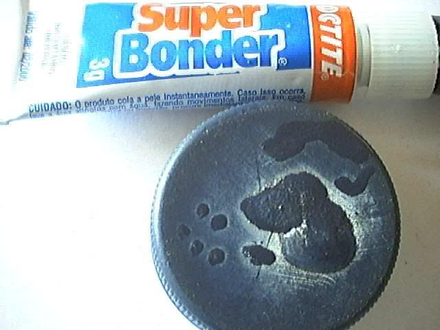

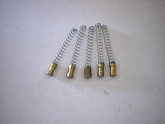

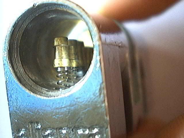

Here is a small update, I decided not to make another video, since pictures will do fine.
Question:
What if the springs stick out of the hole, meaning that the top pins can´t stay in place?
Answer:
Glue the springs and the top pins together!
I told ya it was gonna be advanced :)
:D
Wrenchman

Postby greyman » 21 Sep 2006 17:00
Wrenchman, there's another way that does not involve glue - but it's even more advanced :wink:
You need a front-insertion clip to compress the drivers and springs and keep them in their chambers until you slip the plug back in. There's a few threads on this if you look around.

Postby illusion » 22 Sep 2006 4:46
Hahaha!
If the springs and top pins are proving fiddly, glue 'em! :P
On a serious note, that would work OK untill they become seperated, and I would imagine this would lead to bits of glue flakes in the lock.
