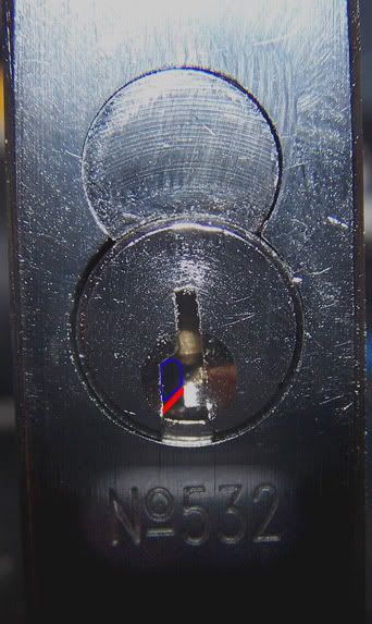

Postby pinsetter » 30 Aug 2006 13:21
As for the lock:
Make a tensor with a blade that will bind in the area of the keyway I've marked red. Fine tune it so that it "bites" a little bit when you apply tension. By doing this you can also use the tensor as a fulcrum point for the pick.
Now you have the area in the blue circle to maneuver a small pick.
This is why I've made so many tensors! If what I have don't work I'll make one that will.
