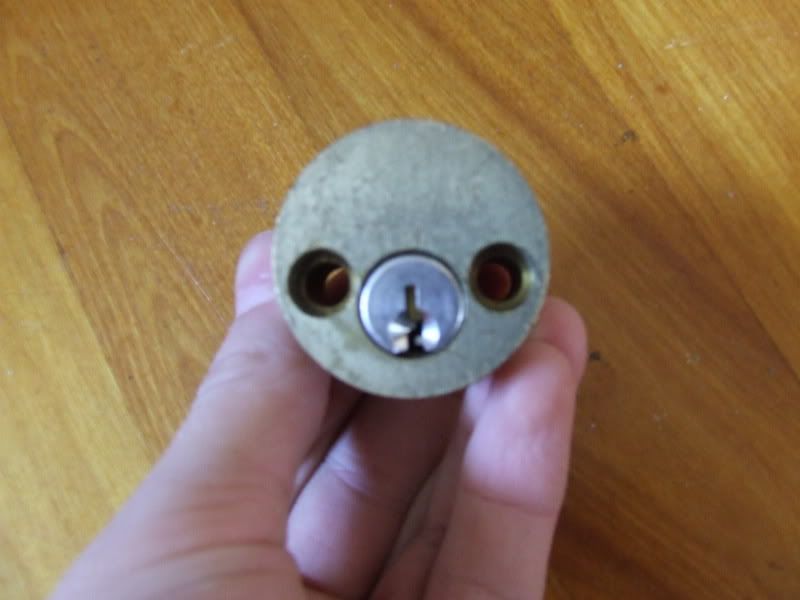

Yes. That schlage deadbolt accepts what is essentially a medeco KIK assembly that slides right into that deadbolt. It IS however NOT UL listed when assembled!!!! That schlage deadbolt it not a UL listed assembly.
Postby unbreakable » 6 Oct 2006 10:42
zeke79 wrote:Yes. That schlage deadbolt accepts what is essentially a medeco KIK assembly that slides right into that deadbolt. It IS however NOT UL listed when assembled!!!! That schlage deadbolt it not a UL listed assembly.

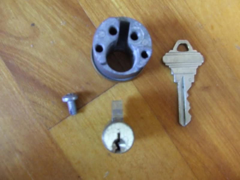

Here's some pics of my Schlage deadbolt that will accept a KIK lock, just to clear things up.

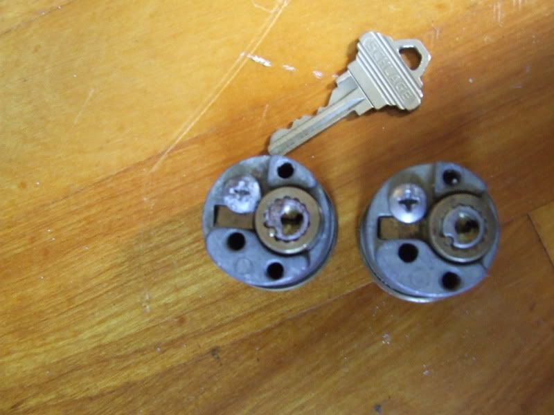

Heres a front view of two of these locks.
Here's a back view of them. Notice the screw? Thats the only thing keeping the KIK in.

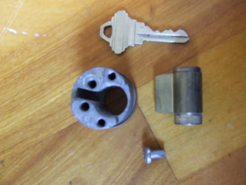

Here's a pic of one of the locks disassembled and the KIK removed.

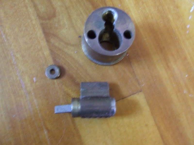

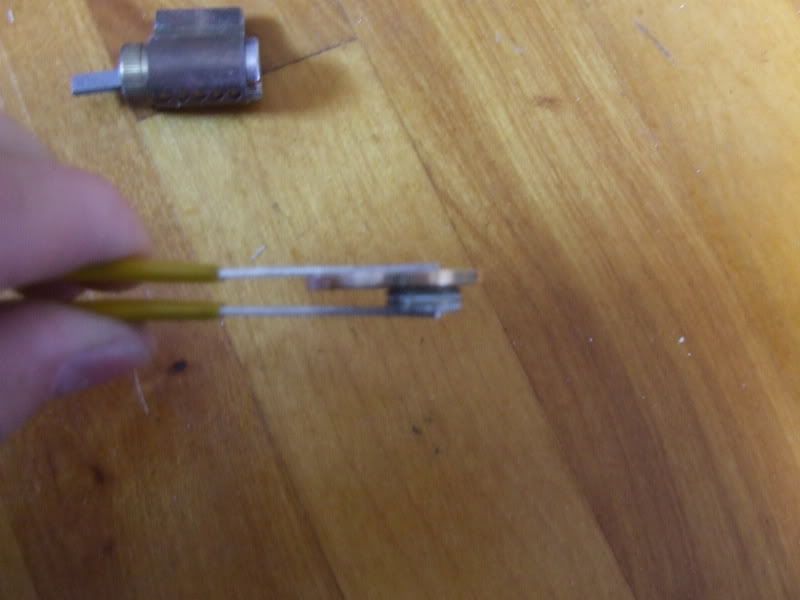

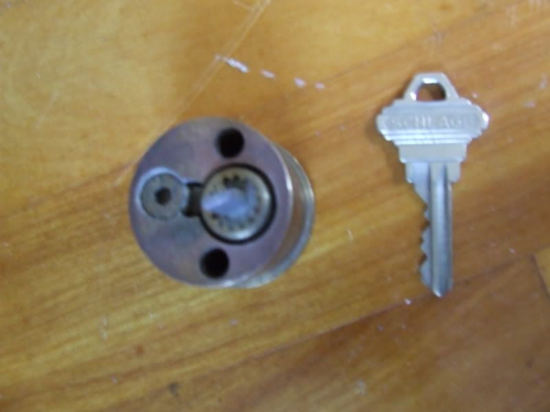

Here's a similar style of lock using a HEX screw instead of a screw.
I was a little disturbed at the size of the hex screw, it doesnt seem very thick compared to a Canadian dollar!
