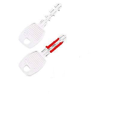

Also, you can file away all but the last two cuts on the key, and you will have a universal warded padlock key that will open any lock in that series.

Postby unbreakable » 11 Oct 2006 20:28
Just to clarify on the key modification-
The red is where you would file away, to be left with a key that would work on all locks in the series.
Sorry for the double post, I hope this helps.
