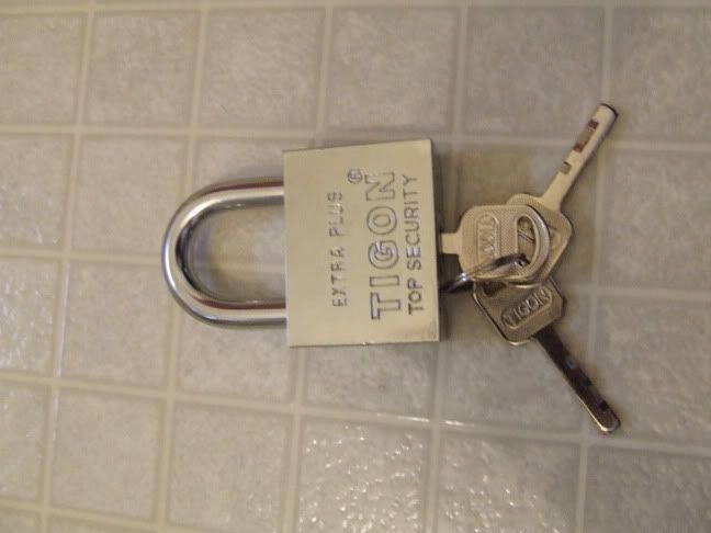

I was wondering if anyone could help me with a padlock I've come across in Thailand. It's called a "Extra Plus - TIGON - Top Security". Strange PL I've never seen other than here. The key is un-usual; it is more the shape of a "4" sided Allen Wrench, with unlocking cut's made at about 10:00 & 4:00 when looking the entry point. There are no disernable pins, nothing visible to manipulate. When the key is inserted there is no internal forced excerted; it merely turns the core. It is not apparent there are any internal springs; after the key is turned it does not "pop" open, e.g. Master Lock, you have to manually pull the shackle out & free.
Has anyone seen these or have a suggestion as far as manipulation. As there are NO spring loaded pins a normal pick & wrench are useless. As are shims; I've tried commercial to fabricated for this PL.
Any Ideas?

the key is a square post, with some cuts on the edges, like kryptonites new double sided abloy system? I think this is an old lock design in thailand, but the same principle as an abloy just discs that align and work somewhat like tumblers on a dial combination, except that they are all set simultaneously by the square shaft key.

Postby Stray » 3 Jan 2007 17:22
I cut mine open I'll take pictures now show how it is made.

Postby Stray » 3 Jan 2007 18:01
well as promised (I was going to make a pdf about this but I just took some quick pictures now since the Poster doesn't have too much time to wait for a PDF explaining it.
Ok Here is my lock (chrome peeled off because i took it to grinder wheel and it got very very hot... lol
Next is a picture of the bottom of my lock with everything removed except the sleeve that turns to free the shackle.
Here is the sleeve ballbearings and shackle removed (as you can tell I didn't quite know how i was going to get the lock open...)
Lastly this is all the parts of this lock minus the key.... as you can see there are 8 disks and 8 spacers. there are 2 types of disks the 4 that turn the plug (on the right) they correspond to the places on the key where there are no cuts and 4 that are there just to keep the sleeve from turning if someone was to stick an object in and turn everything they do not force on the sleeve at all. In my lock all 4 are all identical.
And that is a Tigon Lock. (had I known how It worked before I destroyed it I Probably would have been able to "pick" it, well until I find another one I guess I will never know lol.)

Looks like a cheap rip-off of the Abus Plus disc mechanism, which is a derivative of Abloy. Abus started making these in the early 1980s and many others followed suit. It must be that Abus was unable to patent the design since it's too similar to Abloy (though it's also significantly different since the key is reversible). I've also seen this type of clone in Malaysia, there it was called Rocket or something. Not sure if picking this type of lock is suitable for open forums since it's used a lot on bicycle and motocycle chain locks. But to fill you in, you don't so much pick it as decode it. Have a look around with the search and you might find something relevant.
