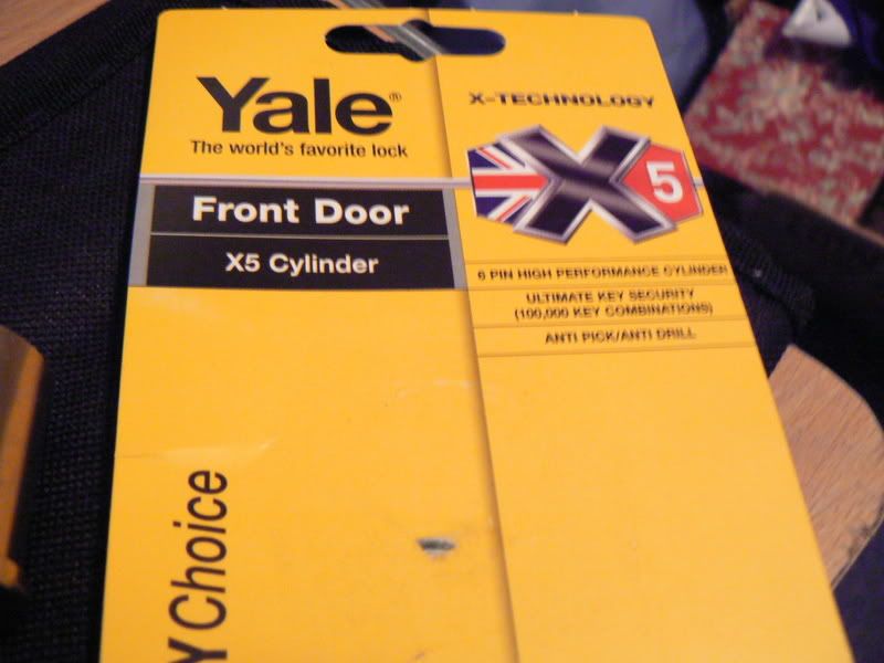

hi all,
today i bought a yale x5 cylinder it has six pins and it says "anti-pick/anti-drill" and "exceeds highest european security rating" so i asume that it has a fair few security pins installed. anyway any advice about this lock?
heres some pics:
cheers
jamesphilhulk2

Its quite a good lock, and normally keyed quite well high / low.
These threads have pictures. Take your time and use light tention, don't get to frustrated if you don't get it!

The bearing has little effect on the drill bit and is too small to interfere too much, its the front 2 pins being hardened steel that cause the grief as well as anti drill pins.
if picking, bumping has proved effective, its an assa lock under yale badge.
