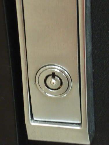

I was wondering if anyone knew what sort of locks these are??
The first one is a type tubular lock .... doesn't looks like a normal ace lock, what is up with the point in the middle?

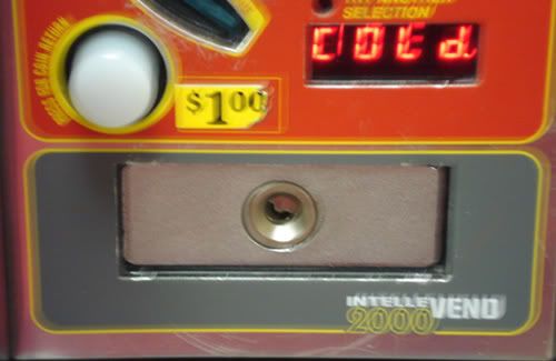

and for this one, i have no idea.
http://i180.photobucket.com/albums/x315 ... neP1LR.jpg

Postby UWSDWF » 22 May 2007 9:57

not sure the first but the second is a abloy classic

Looks like a normal ace to me. Point in the middle is standard.
second one is a disc type lock. Abloy or similar. Recent discussion has revealed that you'll need a shot of the discs themselves (not that hard to see with that big open keyway) to help in a positive ID. But what brand shouldn't matter too much to you at this stage. Just look up abloy (not assa abloy) and you'll find what you need.

I should instill in you, magician, the same point that UW was making. First, the tubular lock you've got there is likely an ACE II which you will not be able to open, and the disc lock is something many of us consider well outside of our abilities. I would say most, but I don't want to speak for everyone.

I've had experience with ACE locks, and i have a set of SouthOrd (7&8 pin) and they get the job done for normal ACE locks, I have never been able to open ACE 2's though. But I've read a few different methods that are on these forums.
I don't think I have any experience with "a disc type lock. Abloy or similar"

Ace II's are easier to work on with the peterson pro-1 tubular pick.

The pointy tip really means nothing, other than it was probably made by LSI.
Although I have seen 10 pin pointies.
http://www.lockingsystems.com/VendingLocks.htm
