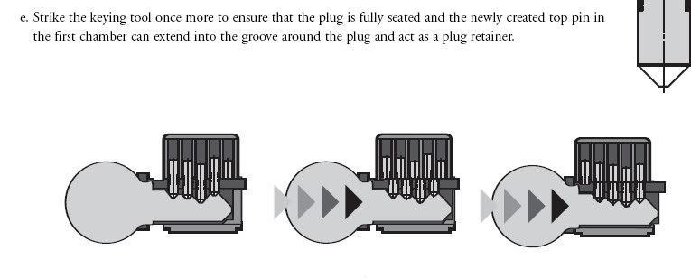

Postby cjames73 » 29 Jun 2007 20:45
theres info on these locks and how to key them in this tech manual,
page 14, No.10
http://keying.masterlock.com/pdf/7000-0 ... l_7-05.pdf
hope this helps

Postby mcm757207 » 29 Jun 2007 20:46
They are a standard 4-pin master lock, except each pin stack is one large pin rather than a bottom and a top, and it is serrated with one serration at each possible depth. You insert the key you want it keyed to, and by punching the cylinder in it shears all of the pins in half at the shear line, leaving you with a working padlock. I use a punch that has a slot cut out of it for the key- you absolutely don't want to hammer on the key because it does take quite a bit to shear those pins. Also you want to make sure you're using a fairly clean-cut key because if it's too warn it won't shear right. They are kinda a pain in the @$$ is you ask me.
You would also think that these serrations would hinder picking, but in my experience they do little for that and they are actually fairly easy to pick. I certainly wouldn't want to impression a key for one though.
I hope I'm clear... it's kinda hard to explain. UP stands for Universal Pin.

Postby cjames73 » 29 Jun 2007 21:12
this pic shows how the system works,

Postby linty » 30 Jun 2007 7:04
you're not supposed to hit the key at all. You have to use a "U" shaped punch that hits the plug on both sides of the key.
I hate these things, the plug is always loose and they are almost invariably "clicky". Terrible idea.
