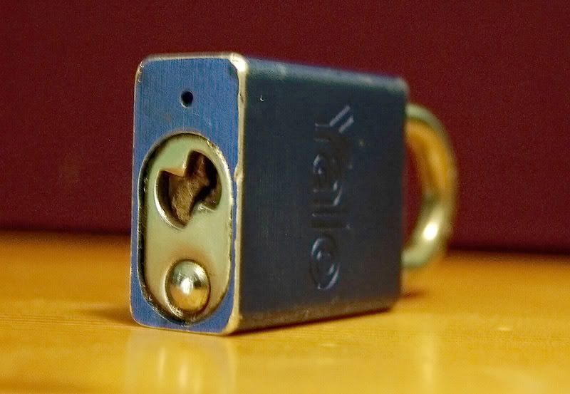

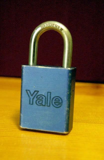

Hi guys, I've been playing with pin tumbler locks, and have got four and five pin basic locks down, but this one is giving me some real grief.
I think its a Yale 600 or K680, its 6 pin, and I was wondering if anyone has had much experience with these, and specifically whether they have any security pins. If anyone could enlighten me on this matter that would be lovely.

by DeeRav » 17 Oct 2007 8:39
Also, what is the silver coloured shield around the keyway, and the large blob. Are these security features (prevent drilling etc) or is it just for show?

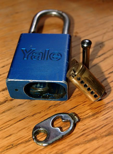

by Jaakko » 17 Oct 2007 10:15
DeeRav wrote:Also, what is the silver coloured shield around the keyway, and the large blob. Are these security features (prevent drilling etc) or is it just for show?
You can probably disassemble the lock. When you open it, look in the shackles hole, there should be a screw. Remove it and the silvery plate drops and the lock cylinder can be removed. The lare "blob" is the nut for the holding screw

- Location: Finland (Pirkkala)
by ilmr » 17 Oct 2007 10:26
The silver color shield prolly adds some safety from drilling and even dust. It also limits the rotation of the plug when a key is used.

by DeeRav » 18 Oct 2007 10:33
Jaakko wrote:You can probably disassemble the lock. When you open it, look in the shackles hole, there should be a screw. Remove it and the silvery plate drops and the lock cylinder can be removed. The large "blob" is the nut for the holding screw
Jaako you were absolutely right! This padlock gets used so I didnt remove the pins, but will buy another as this will make an excellent practice lock. I have been wanting to make a lock with removable pins to get to understand binding a bit better, and this way seems a lot easier than drilling holes etc....

by MacGyver101 » 18 Oct 2007 11:23
You've probably already figured this out... but the holes on the bottom of the cylinder housing are to allow for rekeying: if you insert the key and rotate it 180°, you can remove and replace the bottom pins. (It's easiest, however, to completely disassemble the cylinder if you wish to remove the spring and driver from any of the pinstacks.)

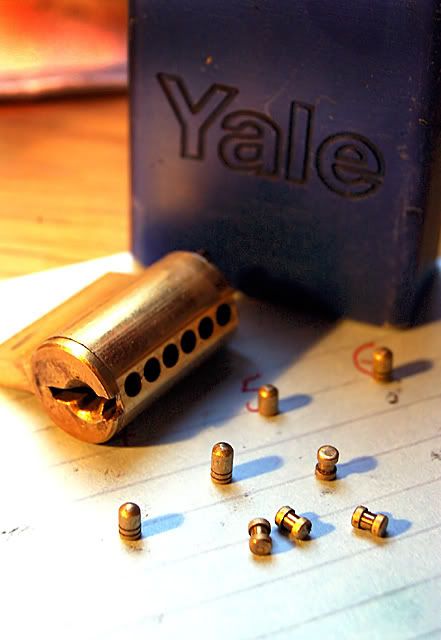

by DeeRav » 19 Oct 2007 11:46
Well, I took the pins out, look what I found.........
5 security spools and 3 serrated pins. Maybe thats why I got nowhere with this!
Still I have put it back together with only 3 pins now, one standard and two security, and am beginning to get the hang of what security pins feel like when they set, and have cracked this setup fairly easily. The only problem I am having is that the further back in the lock i go, the harder it is to feel what is going on, and the less room i seem to have to manipulate the pins. A thinner/smaller pick maybe?

by raimundo » 20 Oct 2007 7:54
While it says yale, it looks completely like an american brand lock so while you breakdown dosent show the bypass sheild, it may be possible to make some hardened wire that will reach clear through the keyway and out the back of the plug to turn the part the plug interfaces with and open the lock without having to pick it. the thing on the bottom is an anti drill hardend plate.
