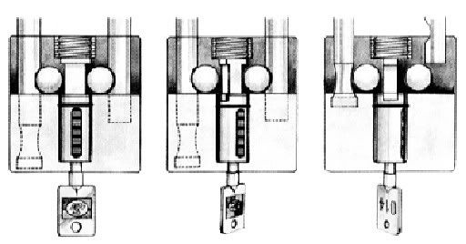

Postby cjames73 » 23 Nov 2007 19:51
you can't shim them then.
as you can see in this pic, the locking balls won't budge unless the plug is turned
