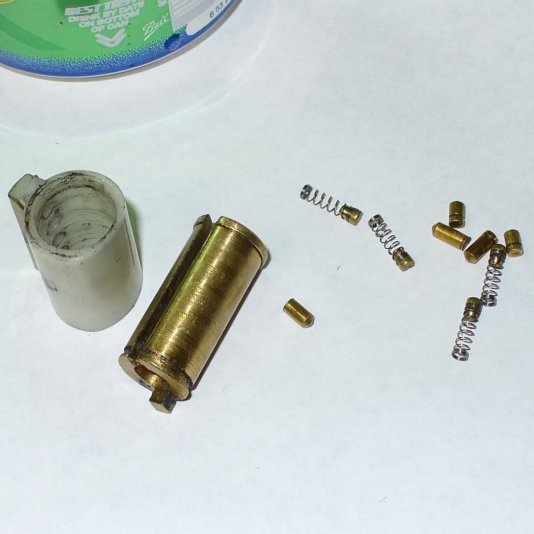

Postby WOT » 18 Apr 2008 16:07
I took apart a generic residential lock with KW1 keyway and the cylinder is plastic, yet it's got serrated pins and top pins that penetrate the springs.

Postby freakparade3 » 18 Apr 2008 16:43
Was it a KIK lock? ALot f those have pins that sit inside the springs

Postby illusion » 18 Apr 2008 17:12
I bought a KIK complete with cylinder on Ebay, to make a cut-away. I was quite disappointed to find out it had a plastic lock housing - mostly because I wasn't able to make a cut-away in the end. I have bags and bags of plugs, but none that were the right size. It's like the song "You've got 10,000 spoons, and all you need is a knife"

Postby globallockytoo » 19 Apr 2008 0:06
Gainsborough locks came originally with plastic bible's in many of their cheaper brands of deadbolts and KIK's. The profile was similar to KW1 but actually used a SILCA GR7 blank, which had a cutout on the bottom tip of the key.
Gainsborough was eventually bought out by TESA and converted all to etter quality products, but still used the same shape head as the GR7 even the profile standard was for the European TE2 profile.
The bottom pins and drivers were a different guage too....so standard lab pins wouldnt work.

Postby WOT » 19 Apr 2008 0:11
freakparade3 wrote:Was it a KIK lock? ALot f those have pins that sit inside the springs
Click on the photo for full size. If you guys haven't noticed, I'm a 1:1 aspect ratio photo freak :)
It's from a no-name double cylinder deadbolt set.

Postby WOT » 12 May 2008 2:37
So the keyway is the same as KW1. Shoulder to first cut is less than Kwikset and cut-to-cut spacing is wider than Kwikset.
What could it be?

Postby Abus » 15 May 2008 15:26
I found a very similar cylinder a few years ago in a dollar store knock-off of the EZ-Set (itsself a poor knock-off of the relatively poor Kwickset).
Picking sensations were very, very strange, though it yielded easily to bumping/pickguns, etc. At the time, it made me wonder if a plastic coated security pin might make for *very* strange picking.

Postby David_Parker » 6 Jun 2008 20:15
Look, its Kwikset hardware. Or Weiser. It doesn't matter, because its trash. The put no quality in most of their locks. The pins in the springs is much like a Schlage F-Series KIK cylinder in that you've got a bible thats actually a spring cover that moves up and down. I've got a photo somewhere. The pins are probably more along the lines of Weisers brand, at least from the very very little that I've seen of their hardware.
