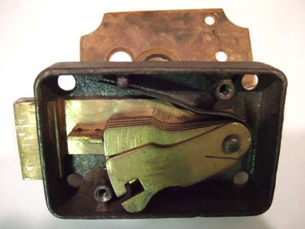

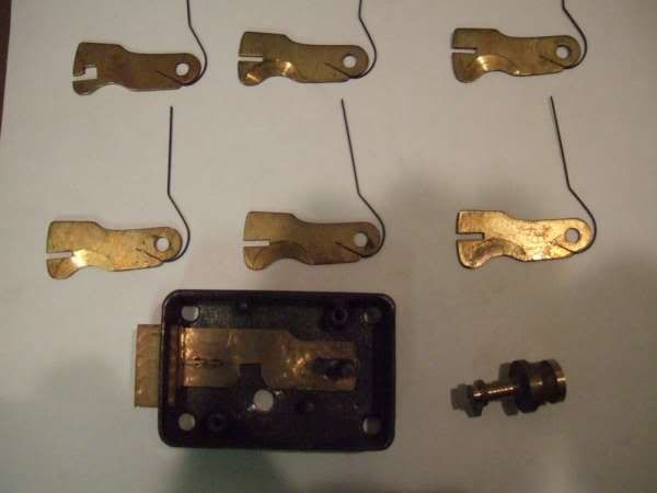

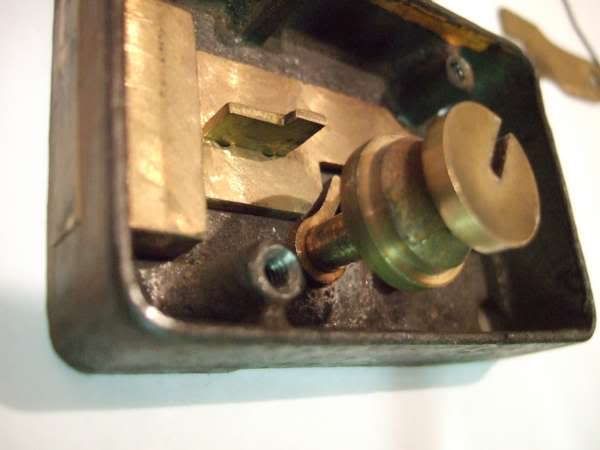

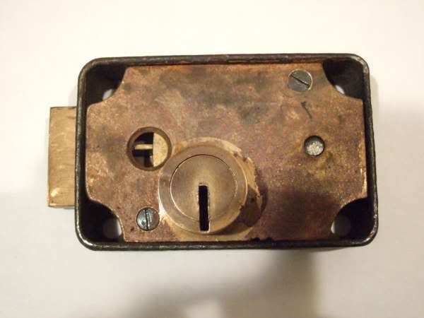

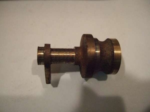

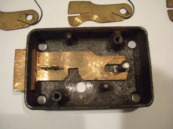

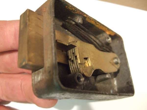

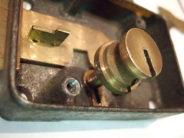

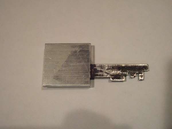

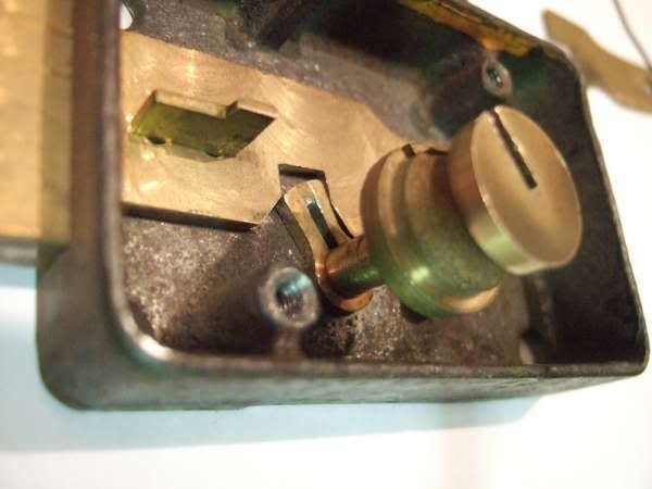

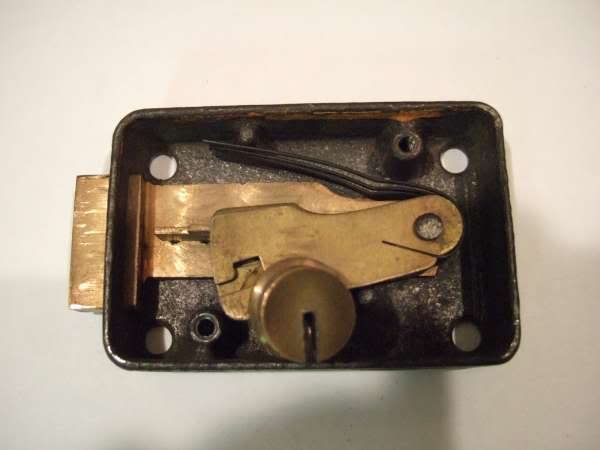

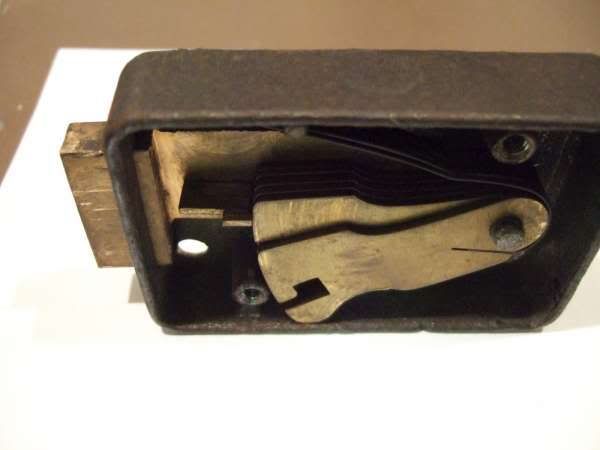

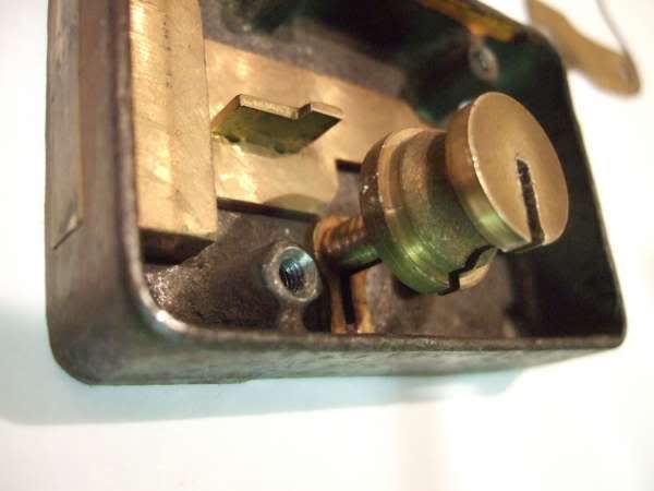

OK, so i didnt wait till tomorrow. the wife'll be mad because i stayed up late to do this, but i felt like doing it now :P

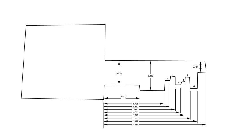

the lock is from the firedoor in a Diebold vault installed in 1906. the diagram of the key has all measurements in thousandths of an inch. i excluded the depth of the cuts as i didnt think it would be relevant to another lock but can give them if it would be helpful.
i hope this is helpful the OP and to anyone else that happens to have an old lever lock that perplexes them :P

Thanks for the post Svaroh. It helps me at least, i just got a couple safety deposit box locks off ebay they appear to be very similar in design to those.

wow. my 3rd post and it gets tossed around forum to forum. i didnt mean to create a such a stir :P i asked for help with something in my first post and soon saw an oppourtunity to help someone else. i didnt expect a kafuffle over a 102 year old lock. ive never tried picking it. didnt have to as i was able to take it apart to make a key. it was on the inner firedoor, not the heavy vault door (which has a combination lock) if that makes anyone feel better :/
