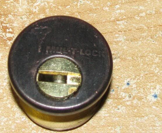

My local locksmith gave me this used Multilock mortise cylinder with no keys for a very good price. I am having a hell of a time trying to pick it. The pins sit all the way on the bottom of the plug making it almost impossible to put a pick under them. I think I am setting some outer pins because I get some degree of plug rotation like what would happen when you false set on a spool, but have not been able to pick it open. Anyone know how to pick this thing with conventional picks?

Mul T Lock use telescoping pin tumblers; pins within pins. To pick a MTL you need to pick the outer pins *then* the inner pins. When you pick the outer pins the plug will rotate a few degrees (it looks and feels different than a false set) and you can focus on inner pins. Inner pins are actually very easy to pick on their own, just raise each one and it will break at the shear line (it sound stupid but it is literally that easy due to the angle at which top pins are held).

Thanks for the help datagram. I found out that the degree of plug rotation was because I had set the outer pins however one of the pins hung on what I think is a serration (Does multilock use serrated key pins?) and it would not open. I had to slightly rotate the cylinder back and the pin fell then I applied tension and got a massive plug rotation. Then picked the inner pins easily and the lock opened though I did run into the 180 degree problem which was not too hard to fix.

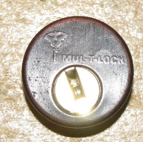

I don't think Mul-T-Lock Interactive (what he has pictured) is considered high security, and even if it was I don't believe it is considered advanced or restricted material.
