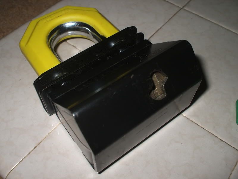

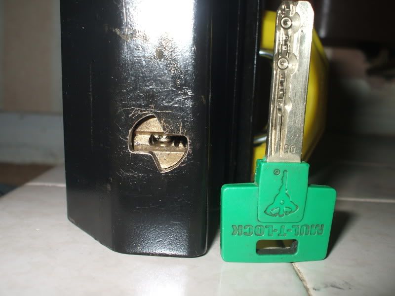

Postby Rickthepick » 5 Dec 2009 14:01
yeah my mate trains and has a shop and gets lots of cool tools and locks.
i picked it with a half diamond and a a short hook iv bent to use sideways, although you only need the hook for the really deep setting pins.
iv just borrowed a mul-t lock pin in pin padlock that no longer works from the key :mrgreen:
pics will follow
Rickthepick
Posts: 1613
Joined: 24 Sep 2009 4:15
Location: Wolverhampton
Re: types of mul-t lock pin in pin
Postby Rickthepick » 5 Dec 2009 14:22
The key works the main pins but then hits false set. I reckon one of the inner pins is stuck, just gotta find it and free it up then pick it :-)

Postby SnowyBoy » 5 Dec 2009 19:56
The plug finish is no indication to the model. For instance the classics can come in brass or nickle finish.
The warding is a good indication to the model. The padlock is an 05 but the most common model is the 06 (can see the inner ward on your 05 is slightly thinner than ure 06 euro, at least it looks to be an 06, the angle of the photo doesn't help)
There are a lot of wardings as I have learned bringing lots in as stock, I've even got a no ward MTL key :)

Postby Rickthepick » 6 Dec 2009 4:27
On the silver ones the warding is a mirror image of the brass finish

Postby datagram » 7 Dec 2009 11:32
Rick,
A full write-up of Mul-T-Lock telescoping (pin in pin) systems and their differences is available here:
http://www.lockpickingforensics.com/articles.php
The locks in the pictures above are all MTL Classic with 005 and 006 keyways.
