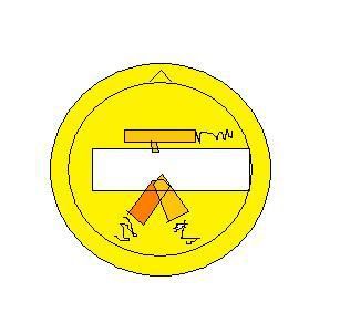

Postby Rickthepick » 16 Apr 2010 8:05
heres the jist of it in a very primitive paint sketch
sidebar at the top

Postby Rickthepick » 16 Apr 2010 8:20
I reckon its pickable... but not by me :lol:
My first impressions were definately wrong, this is a very good lock. 8)
