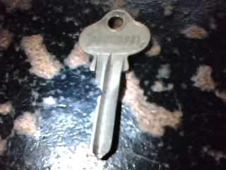

Postby eurolock fan » 8 Apr 2010 10:26
(as posted on UKBK)

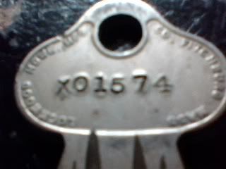

I found this in my collection. Its a Lockwood key but its made in Mass, USA not AU.
Anyone have any idea if Lockwood locks were made here in the US at one time or just blanks or what.

My parents house in Massachusetts has a Lockwood mortise cylinder on the front door they don't use. I believe Lockwood was popular around here back in like ~1950-1970, and now it's owned by ASSA Abloy Group and sold mostly in Australia.

I don't think that there's a connection between the older American "Lockwood" brand and the Australian "Lockwood" brand. The "Lockwood" brand first appeared in Australia in 1934, and has always (to the best of my knowledge) been produced there. I have pinning charts for the American "Lockwood", but I can't find a lot of info on their company history.

Here is a USA Lockwood vintage cylinder logo:
Do any vintage Australian lockwoods have the same logo? That would probably answer the question.

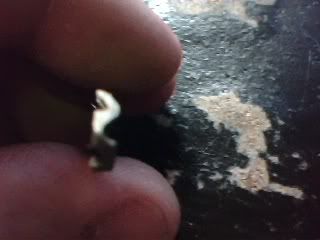

@eurolock fan:
That looks like a standard simplex profile Lockwood keyway...
"American" Lockwood is still producing locks... They are just an obscure older brand at this point in time that has been forgotten for the other manufacturers who are all divisions of a few bigger multi-national-conglomerate corporations... Such as Assa-Abloy, Ingersoll Rand, Black and Decker and Stanley...

All they have up on their website is catalog cut sheet portions, no technical information at all...
Many large institutions back in the day used to use 6 or 7 pin systems using Lockwood sectional keyways...
